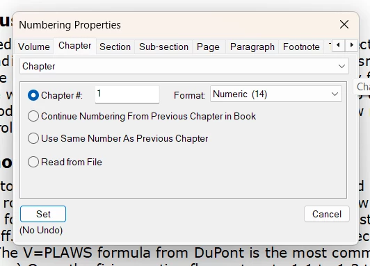

    Susan305351693t3o
    March 26, 2025
    Hi Frameexpert,
    If I'm interpretting what you're saying correctly,  I'm taking the following steps:
    I select an element from the book (I assume that means chapter?). I'm choosing the one that's having the numerical problem:
    And select "Numbering"
    This is what appears:
    The tab for "Chapter" is the tab selected. My chapter numbering is fine, so I'm going to select another tab, though I'm not sure which one. So I select "section," as it's a section within a chapter. This is what comes up:
    All selections are grayed out, so I can't do anything. If I COULD select anything, I'd select "continue numbering from previous section in book" (though I don't know how that would affect the first section in the book, which I want to be the "start," not the "continue.").
    I figured "Sub-section" might have selectable options:
    This tab has nothing selectable either.
    I haven't seen any "inconsistent numbering" dialog boxes, so I suspect I'm not looking in the right place?
    What am I doing wrong? Maybe I'm using a different version of FrameMaker that you are? I'm using 2020.
    Thank you.
    Susy

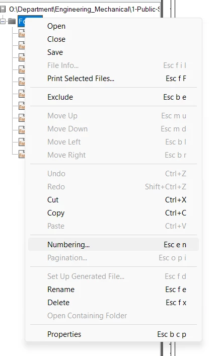

    frameexpert
    March 26, 2025
    I'm sorry but I'm a relative newbie and in my trainings, that has never been covered. I don't know you mean by "documents in folders." Should I take all of my book chapters and put them in folders? Or should I take all of them and group them into a folder?
    This sounds really important and I can't believe that my trainer didn't cover this. We had about 8 1-hour sessions.
    I'm going to take a stab in the dark here, as I really don't know what I'm doing.
    I right-click on the FOLDER instead of the individual file, and select "Numbering" from the dropdown list:
    This comes up, which I believe is the same menu that comes up when I do this with individual files:
    "Section" and "Subsection" are still grayed out, which must mean that what I did with putting all of the files into a folder is NOT what needs to be done.
    Can you tell me what you mean by "folders" and "groups?"
    Sorry to be so obtuse. I've never had this problem before, and my trainer never covered this.
    Thank you,
    Susy

    Bob_Niland
    March 26, 2025
    It appears that you aren't using a Series Label for the numbering.
    This might appear as the H: in a
    Paragaph Format /Numbering\
    Format: [ H:‹$chapnum›.‹n=1› ]
    If the case, various stray numbered paras of other types might be resetting the default counter.
    …which is one reason why the Series Label feature exists.
    Also, check the Numbering properties from the Book menu for each chapter (it's a right-click option), plus within each chapter (Format🞃Document🞂Numbering…), esp. the chapter that's resetting to 1.
