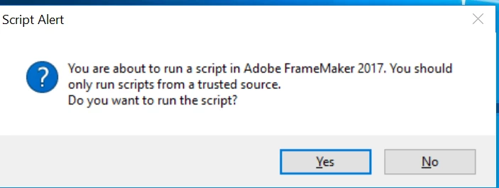

Jacob_AA
Jan 18, 2019 6:22 AM UTC
I'm running extendscript in command line and get an alert.
../ExtendScript Toolkit.exe" -run exampleScript.jsx
Does anybody know how can I disable this ? or is there any good way to run the extendscript in non interactive mode.

I run extend script in command line:
it works okay but I don't want to press yes each time to avoid the alert.
4everJang
Jan 18, 2019 8:21 AM UTC
Then you need to create a command for it and add it to one of the menus - or create your own menu. Then the command will be run from within FrameMaker instead of outside - which may be seen as a malicious attack. If the alert would not show, a mail attachment could automatically fire a script and do something disruptive.
