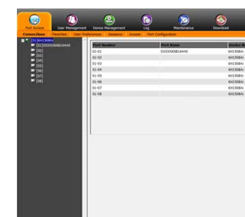

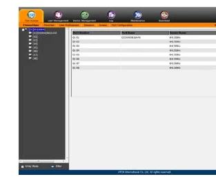

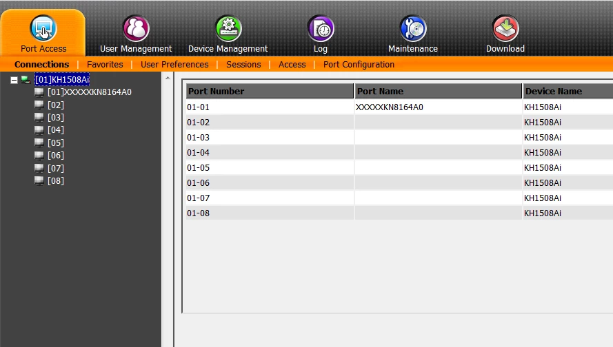

I'm importing high resolution *.tif screen shots into FrameMaker 12 but after I create the PDF they come out low resolution and blurry. Examples below. I've been doing this a while and never experienced this before.

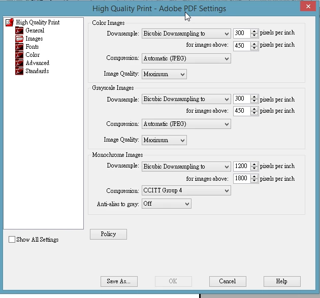

I tried changing the Print settings as well:
Original .tif image
Image in PDF @ 100%
Image in PDF @ 300%

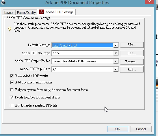

    Here are my settings, what do you think? I'm using .tif files. I'm unsure about chaning them because i fixed the issue by directly saving as PDF instead of creating the *.ps (Distiller) file first.
    Matt-Tech Comm Tools
    Mar 1, 2018 8:00 PM UTC
    With what you're using, the images are being converted to JPG (lossy compression) and (if above 450 ppi) downsampled to 300 ppi.
    Both will cause loss of detail (fuzziness or mottled images)
    If Save as PDF isn't causing the same softness, then you have the settings in your PDF Setup in Fm set differently.
    The bottom line is that you need to use what works for you and what you can manage, so perhaps the Save as PDF is all you need for now.

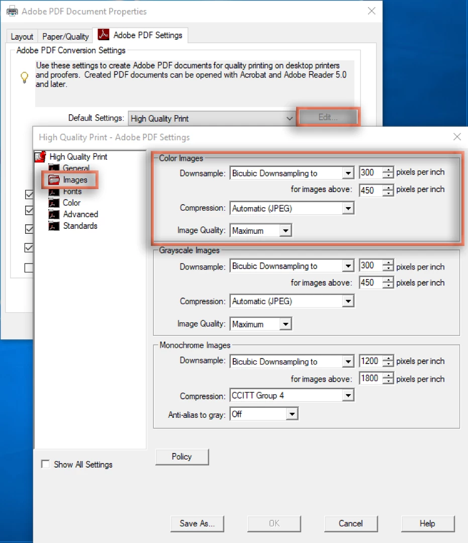

    Hi bretta96408991:
    And if you aren't sure what you are looking for, here are the default settings for High Quality Print. That's a color image, so only the Color Images settings are important. As a default, they are set to downsample (reduce the resolution) of any file over 450 ppi down to 300 ppi. JPG has variable compression (can compress a little or a lot), so the Image Quality value is also very important.
    What is the resolution of that image, and what are your Color Images settings?
    ~Barb

    To clarify what Bob wrote, disable Sampling, and disable Compression and see if it clears up the problem.

    Mar 1, 2018 7:11 PM UTC
    Hit the [Edit] button next the "High Quality Print", and see what it's actually using for subsampling (dpi) and compression (algorithm).

    Mar 1, 2018 7:08 PM UTC
    Chek your PDF joboptions settings. It looks like your getting a fair amount of downsampling and jpg compression being applied.
