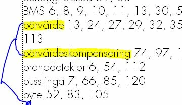

In Swedish we have 3 letters at the end of the alphabet, å, ä and ö (in that order). If I make a table and ask FM to sort it for me, all letters come in the right order. But if I create an index FM treats ö as an o, and å and ä as a.
Is there a way to fix this? We use FM 7.2

    I have now made a "dummy" index, just to explain what I mean (I changed the type so it's easier to see).
    This is the result I want, the index sorted right:
    A
    alla 14
    Annat 14
    C
    chans 14
    CW working 14
    F
    frånslagen 14
    O
    orsak 14
    P
    parentes 14
    Å
    Ågren 14
    åker 14
    Ä
    är 14
    Ärla 14
    Ö
    öken 14
    Övrigt 14
    All letters sorted in the right order, and no difference between upper case and lower case

    As you can see å and ä is under A and ö is under O.

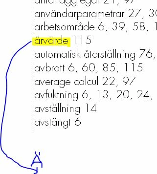

    For some reason a, å and ä is in the beginning under Å... ö is under O.

    I understood what you meant, but didn't have any documentation available, and so was trying the wrong thing.
    I've just read Specify sort order for an index in the FM12 help, and it is now clear to me that the SortOrderIX paragraph is what needs changing. I have replaced the <$alphabetics> building block with its default value (as given in the above page of documentation), and then moved your Swedish letters to the end of the sort order. This is the result:
    • for the GroupTitlesIX paragraph:
      Symbols[\ ];Numerics[0];A;B;C;D;E;F;G;H;I;J;K;L;M;N;O;P;Q;R;S;T;U;V;W;X;Y;Z;Å;Ä;Ö
    • for the SortOrderIX paragraph:
      <$symbols><$numerics>AÁÀÂÃaáàâ㪠Bb CÇcç Dd EÉÈÊËeéèêë Ffƒ Gg Hh IÍÌÎÏiìíîï Jj Kk Ll Mm NÑnñ OÓÒÔÕØoóòôõøº Pp Qq Rr Ss Tt UÚÙÛÜuúùûü Vv Ww Xx YŸyÿ Zz Åå Ää Öö
    It works for me in FM12.
