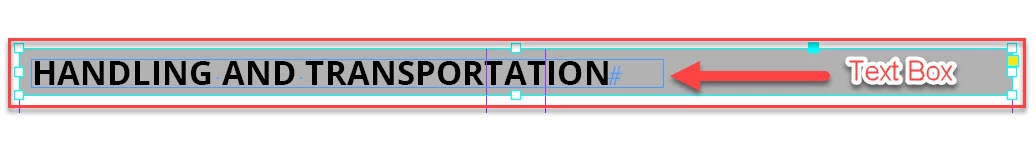

Is it possible to apply the background color of a line into the whole width of a column?
I'm trying to copy the H1 style utilized in an Indesign document also in my Framemaker document. I've thought that the "Background" color setting in paragraph styles could solve my issue. The problem is that the background color is only being applied to the text and not to the entire width of the column. On Indesign they did use a box for H1 headings and then inserted a text box into it. I think that the paragraph styles won't allow me to automatically combine graphical boxes for specific styles. Also there are some other headings in lower levels (H2 and H3) in the manual which do utilize background colors but not all of them.

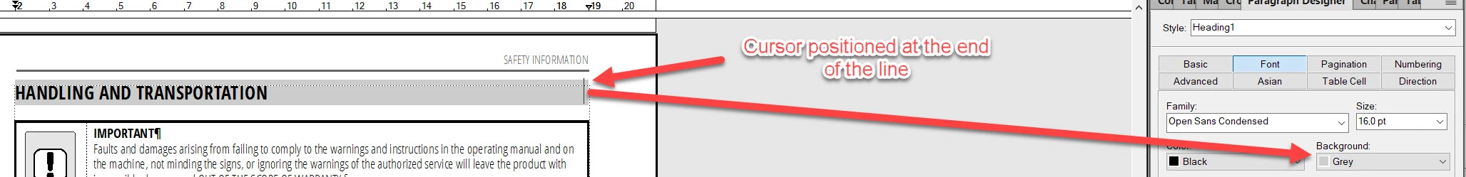

I've thought that inserting empty spaces at the end of the line would solve my issue but then realized that this would cause the TOC to also show these empty spaces and also I'm going to utilize some conditional tags in some of these headings which doesn't allow me to understand how many spaces I would require before the exact end of a line.
Do the paragraph style options in Framemaker provide us with a solution to apply the background color to the whole width of a column with text shorter than the column width?
An example of the H1 heading boxes on Indesign is below
What I've tried in Framemaker to achieve the same effect is below (there are empty spaces at the end of the H1 text)

Using "background color" is the wrong approach and only meant for the text itself. Instead, go to the "Advanced" tab of the paragraph designer and choose a color in the Pgf box drop down list. This will create exactly the appearance you're looking for.

Exceptional guidance. Much appreciated.
