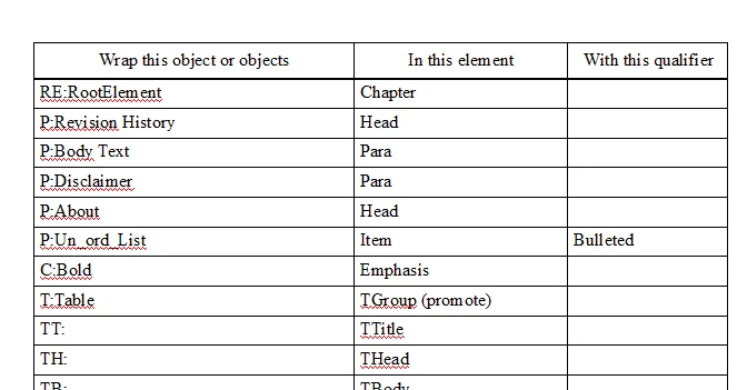

Here is what I have:

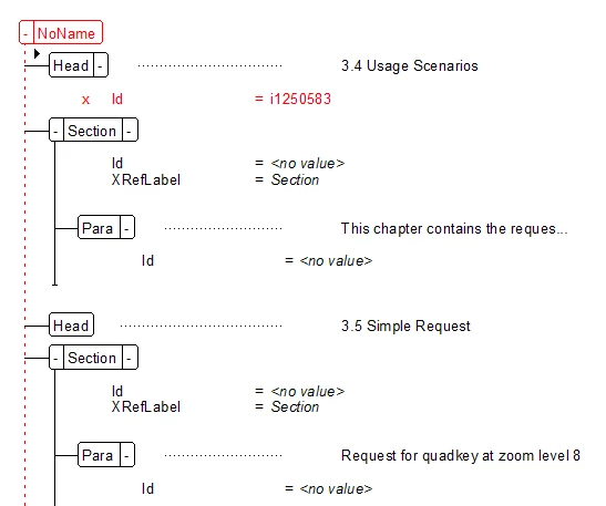

The no-name element appears in the actual document that results, like so:
In this scenario, I am just running conversion tests on individual files within a book, and the NoName element appears at the root level of the individual file, so I don't think the book update will be of help yet. Once I do put these files back into the book they belong in, a book update will remove the NoName element at the book structure level - but only if the files have correct root elements to import.  Right?

As I recall, my conversion table goes from low level to high level. Hence, I first apply character elements based upon character format tags, then apply paragraph level elements based upon paragraph format tags. Then the table looks for collections of elements (eg, Item elements) and wraps them in their container elements; for example, Item elements are wrapped in List elements. Then on up the ladder. My final entry in the table is the root element specification.
Looking at your table, the root element is the FIRST entry. Maybe that is the problem.
