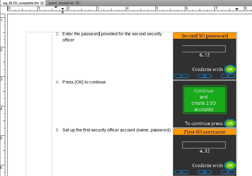

A basic layout question which I've somehow never run into before … the screenshot shows almost what the document owner wants; but I would like more vertical space between each graphic and the next paragraph, and (see point 5) a bit more horizontal space between the text and the graphic
Properties so far:
  • anchored frame – run into paragraph, right align, gap 6.0 pt
  • graphic – run around contour
I experimented with a run-in head paragraph for the text and a right-aligned paragraph for the graphic, but then I couldn't work out how to align the graphic to the top of the paragraph.
Hints and tips welcome!

    Increase the vertical size of the anchored frame I do this with software command icons except I left align the anchored frame. You can also set a object style to quickly offset the graphic to the upper right corner of the anchored frame.
    July 16, 2015
    extend the frame … yes, I can live with that :-} thanks for the tip.

    The paragraph format could have an empty FrameAbove or FrameBelow, but you'd need to test FB for conflicts. FA has the [dis]advantage that it will work at the top of a page, whereas SpaceAbove does not.
    The pgf can also have extra SpaceAbove or generous Space-Below.
    But I used to do it by pulling down the bottom edge of the anchored frame, as already suggested.
