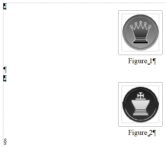

    Jun 28, 2018 8:25 PM UTC
    Suppose the graphic frames are anchored in the paragraph above:
    Usually this paragraph above has a special paragraph tag, e.g. 'Graphics'.
    Set up a new list of figures containing two paragraph tags:
    • Graphics
    • FigureTitle
    It will look like this:
    Do some magic with regular expressions:
    • Find: ^(.)\d*\n(.)
    • Change: $1$2
    Now it will look like this:
    Create a PDF. The links should work as desired.
