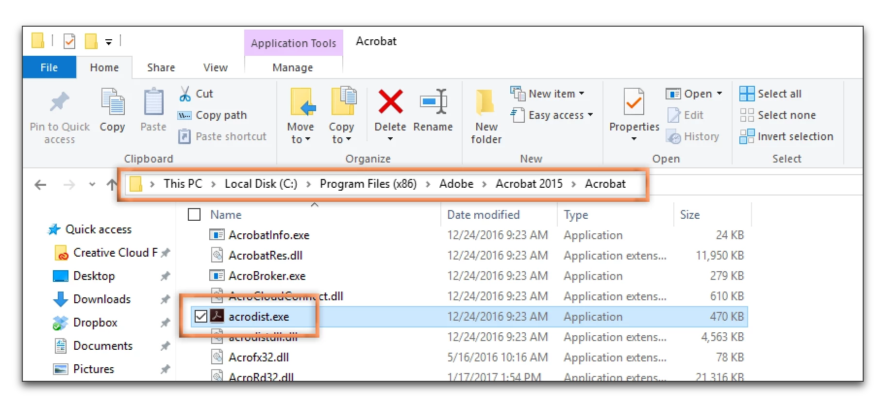

For troubleshooting purposes....We are using Adobe Creative Cloud and I was attempting to update all my software to latest version.  All software (Photoshop, Illustrator, etc.) updated correctly, but there was an error with the installation of Acrobat DC that apparently wiped out my Distiller. The folder above indicated by BarbBinder has no acrodist.exe file. I thought it might be a "permisssions" issue with IT, but everything else installed/updated without problems and Acrobat Reader DC still works fine. I retried the installation with the same results. I will attempt to resolve this issue using input from the discussion above.  Thanks again for your assistance!

And what version of Acrobat do you have installed? You can open Distiller from within Acrobat (and with the version number we can give directions), or from the acrodist.exe on your hard drive. See the path outlined below. I'd check that before you uninstall/reinstall.
