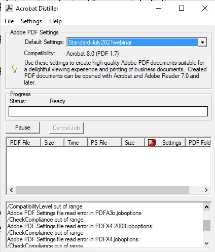

    You should be able to use the Settings > Add Adobe PDF Settings option within Distiller to add your joboptions file. However, when I tried to PDF/X4 in this way, I got an error. (see screen shot at the end)
    You'll have to weigh implementation of your X4 requirement using Distiller, versus using the Publish method and its advantages/disadvantages.
    That said, the X4 joboptions should just be a collection of settings...if you can't add to Distiller, and you aren't able to take advantage of the Publish route, then I'd recommend posting in the Acrobat forum. If that doesn't help, perhaps tweaking a new or existing joboptions file based on X4 validation errors would get you what you need.
