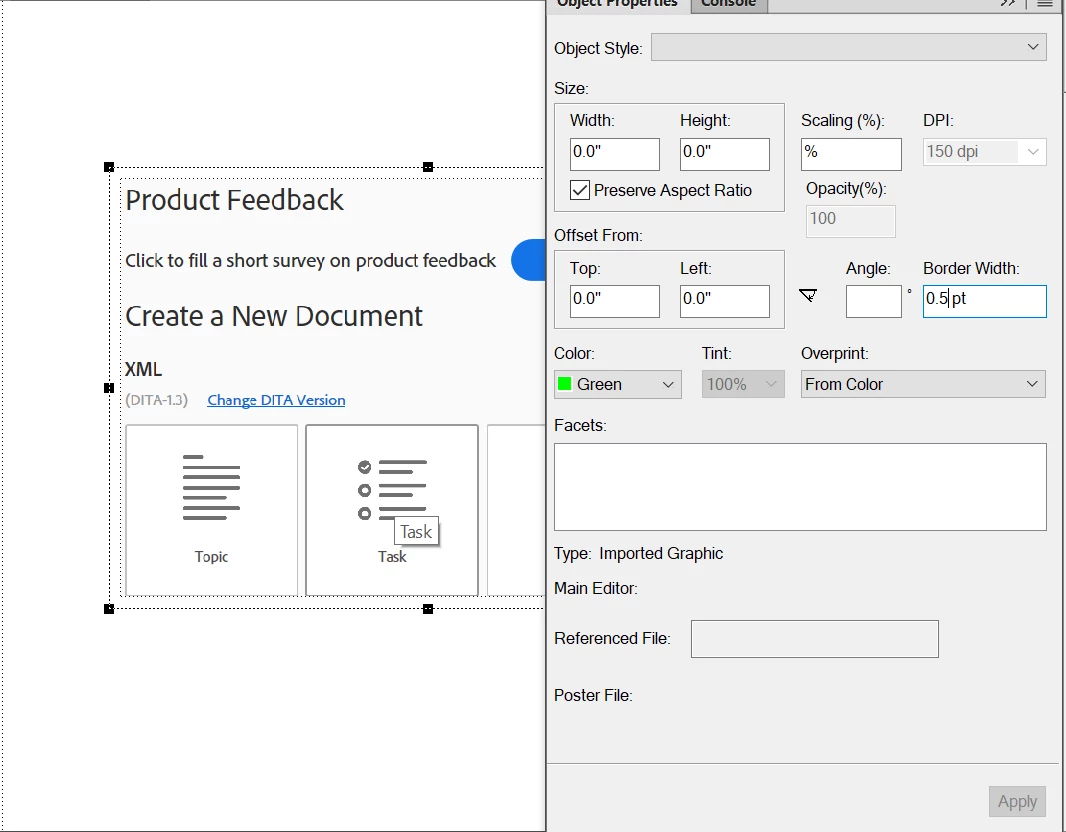

I am using FrameMaker Version 16.0.1.817 and would like to set the border color upon insertion of a figure. In the past, FrameMaker version I had this was not a problem at all, but with the new version it stopped working.
Here is what I did:
- Insertion of a jpg image (or png image) with File > Import > File > 150 dpi
- Choose object properties and changed the border colour to green as shown in the attached screenshot
- Click Apply.
But unfortunately nothing changes. Does somebody have an idea, why this is not working anymore (or can share a workaround)?

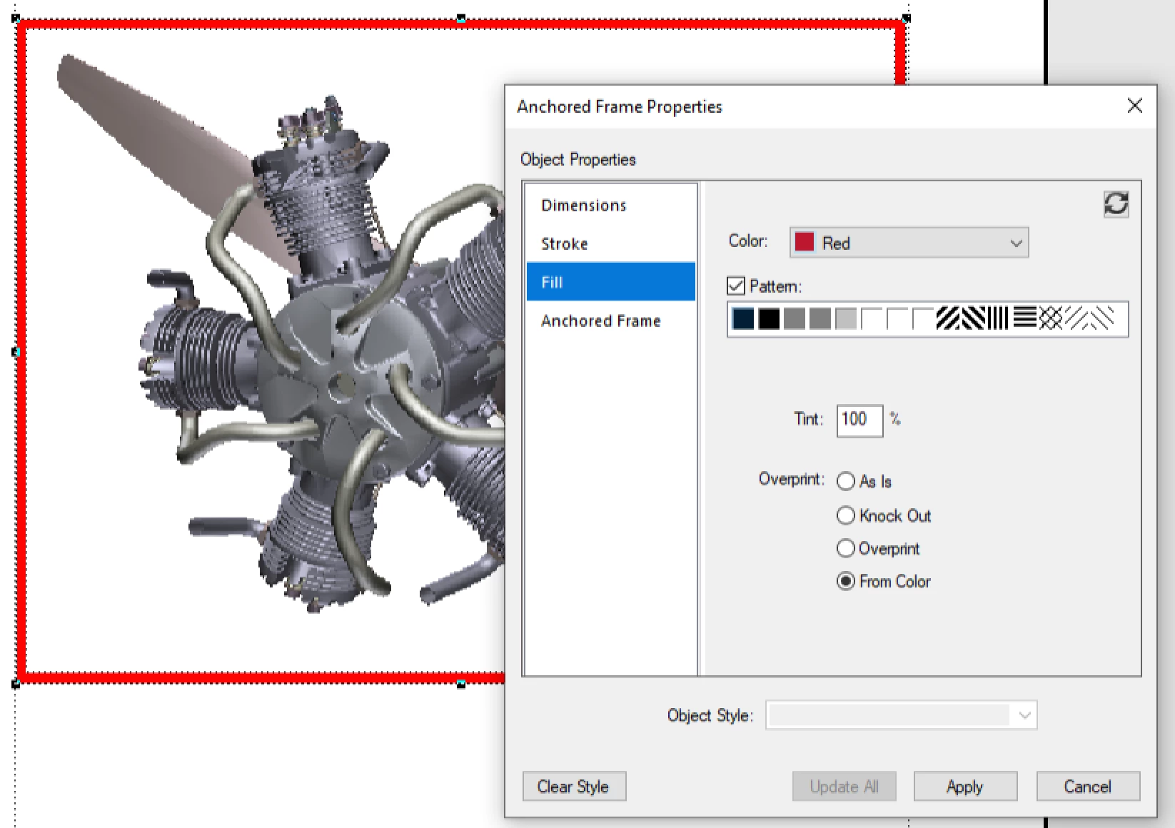

    Edit: I just looked at your screen shot. The Object Properties box is context sensitive. The one you have open is for the image but you now have the anchored frame selected. That's why Apply is grayed out.
    Select the frame and reopen it. It will now look like the image below, which is entirely different. It varies with each selected object.
    I don't want to confuse you with the screen shot with what appears to be a border below. I actually added a fill to the frame (entire frame is red) but the image on top falls short of the frame edges, which is why it looks like a border.

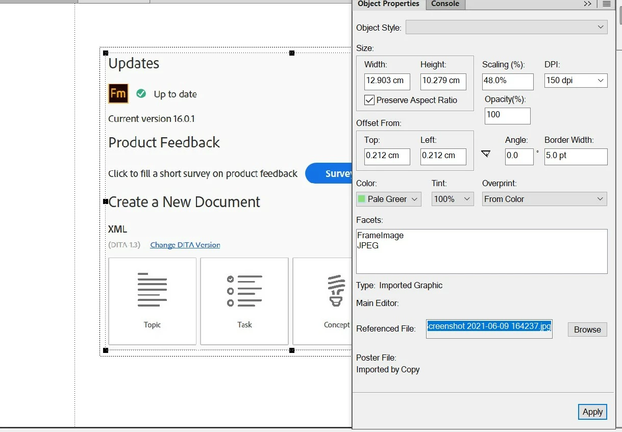

    Jun 14, 2021 7:58 AM UTC
    Hi Barb,
    thank you for your reply and your help with that issue. But I do NOT want to color fill the frame around the image. Instead I would like to have the border of the image colored with 0.5 pt, which will look like a frame in the end. As far as I know this is controlled with the object properties pod (at least it worked like this in previous versions of the software)?

    Jun 11, 2021 6:21 AM UTC
    Hi Barb,
    thank you for your quick reply.
    When I select the frame containing the picture and change the colour, the apply button is not available (i.e., greyed out)(see attached file).
    So this is unfortuntely not working for me. Do you have any idea, why changing the border color does not work for me and my FrameMaker version?
    Thank you for your help!
    Verena
    Jun 11, 2021 6:33 AM UTC
    Hi Verena,
    You want to create an object style and apply this.
    Therefore open the Object Style Designer in the Graphics menu and create such a style.
    Then you can apply this in the Object Properties panel.
    The Apply button in the Object Properties panel is grey, because you had selected the anchored frame. The Object Properties panel is for the image.
    Best regards
    Winfried
