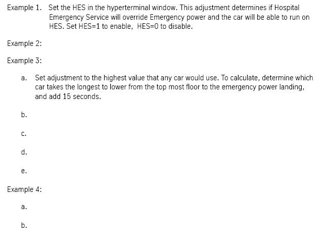

    January 3, 2011
    Below is what I did.
    E:Example <n=1>: \t (This would be called example1.)
    E:Example <n+>: \t (This would be called example2.)
    Then for substeps it would be as any other substep. I used "a" as the series number for "answer".
    a:<a=1>. \t (This would called substep1.)
    a:<a+>. \t (This would be called substep 2.)
    You of course would have to set up your tabs for the tab (\t).
    Hope this helps. (There is a mistake in the pic below because I didn't update all...just noticed...There should be a ":" after Example 1:. It is correct in the above series numbering.)
    ls
