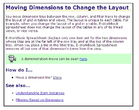

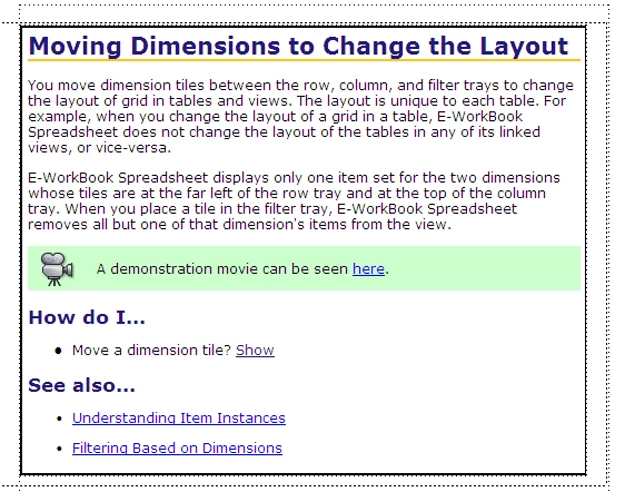

    Thanks for responding Sheila. I am using FrameMaker 9 (although I did state that) and Win XP which I doubt is the issue here. If you look at the image below, taken from my FM file, the image clarity isn't too bad.
    Now look at the output in the PDF.
    The image is taken from the same user, PC, monitor, etc. as is being used to edit the FM file. It is a PNG image although I've tried TIF and JPG with the same results. The image above hasn't been resized in any way so that can't be the issue.

    I am a little confused. In your examples, what is the png image? The movie camera, or the whole thing including the text? If the former, I see little difference. If the latter, remember that Acrobat Reader makes little effort to make screen view as crisp as possible. For example, it does not anti-alias text. If you zoom in, text gets clearer.
    In general, PDF output should be better than your screen display, as long as the distillation process is NOT resampling or lossy compressing the bitmap images. So, if your png images are created at 300 dpi and you set the PDF job options to smallest file size, the PDF will not display images at 300 dpi quality. Both smallest file size and standard job options resample images at resolutions above 150 dpi.
    I suggest opening Acrobat Distiller and select one of the best quality job options and edit it to turn OFF image resampling and turn OFF image compression. Save this job option. Then try varying the resolution of your png images to find the optimum quality for your project. By turning resampling and image compression off in the distillation process, you know that every bit of your image is carried through to the PDF.
