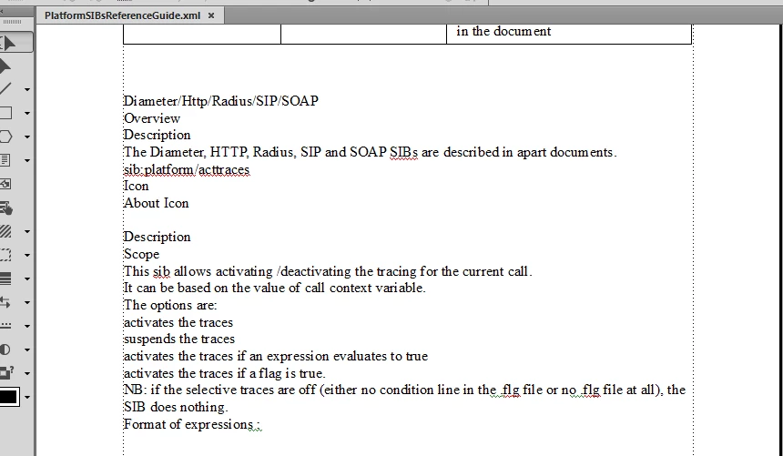

I got the xml files, which are used with Arbortext XML Editor 5.3 in DITA, it has all the DTDs and styles files. I want to use the same XML files in FM to work with either in structures or unstructured way, I'm novice to structured FM. When I open XML file in FM it ask to choose Structured Application, I have chosen DocBook, Xdocbook but not getting it what i want it displays as simple plain text without any style, formatting, and images.
I just want the same look and feel of Arbortext some changes here and there i can manage though. I need to know what exactly I need to change, attaching the screen shot of XML file and file which opens in FM.
What can I do to use existing XML in FM 2015 or 2017.

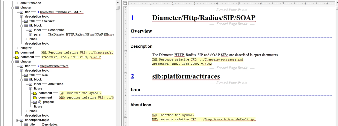

First: What you do (or don't have)
Looking at the markup, you have something that isn't pure DITA. Based on my experience, I'd say it's partially resolved, a merged version of the original source files into a larger single-file conglomeration. I say that because the comments indicate two things to me: (1) the file name and boundaries were preserved in the comment that says "XML Resource relative URI..." and (2) the presence of the Arbortext version comment which always appears at the top of a new file created in Arbortext.  For these to appear mid-file means that you have a file that is the result of a bunch of other files merged together.
Arbortext can do this "merging" but the result does NOT look like the markup structure I see above (it doesn't create tags like "description_topic" for example). I can only assume that other tools can also create this merged/resolved intermediary file typically seen later in a DITA processing pipeline. I do not know what tool created the file in the screenshot you provided nor do I know what process was used to create it. I do know that it is not DITA, not DocBook, and was created by some external process (that wasn't Arbortext).

allenr57336305,
I have little experience with Arbortext, but from your screenshot, your file does not look like DITA. If it was DITA, it should just work. I also don't know enough about DocBook to know if your file looks like DocBook.
If this is a custom DTD, it is a complex task to use FM as an XML editor. It can take weeks to months to get it working, especially if you don't know anything about it. It sounds like you may be a bit overwhelmed here. If my suspicions are correct, nobody can tell you exactly what you need to change to make this work... you should prepare for a very long process, or just keep using Arbortext.
