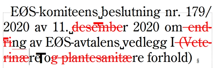

Result: a lot of comments are imported with the wrong location. Seems to be offset 1-2 glyphs to the left for some reason. This makes the feature effetively useless for us:
(In this screenshot the ending of the two words happen to both be "ære" but it happens with other words not containing those characters as well).

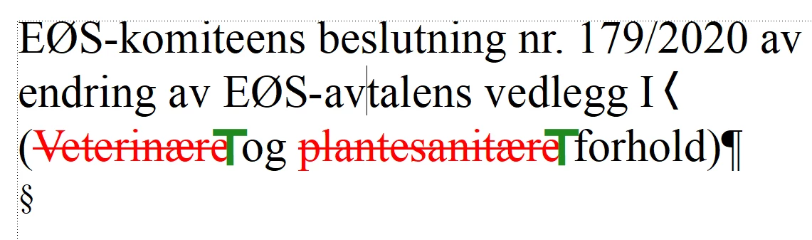

    As it happened exactly after "æ" in both instances, I first thought that it might be some bug related to that. I then recreated the document as a normal unstructured document, run it to online review again, and it worked just fine:

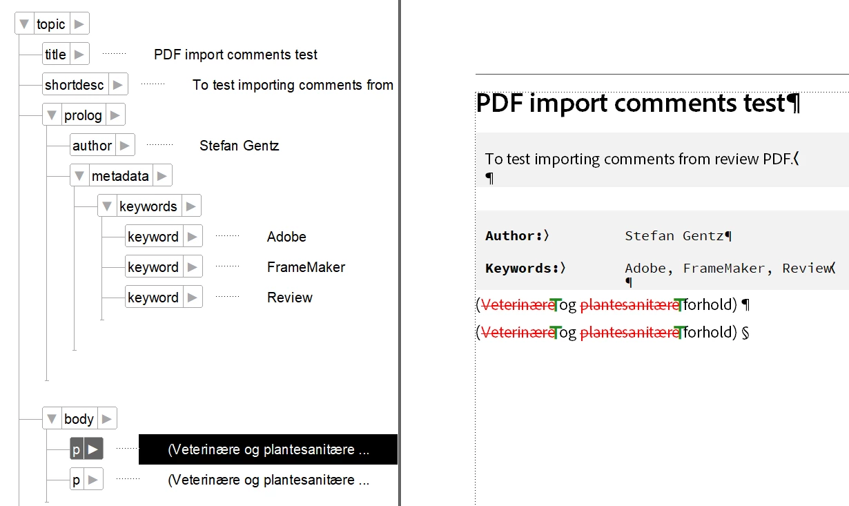

    Finally, I ran a test with a normal DITA topic and, it worked just fine:
    Bottom line is: I cannot reproduce it with a classic FrameMaker document, nor with a DITA XML file. It just happens with your document (even after fixing the structure validation and playing around with other things like fixing the paragraph format, adding an additional paragraph, etc.)

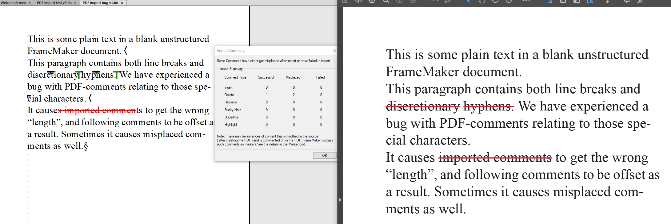

    Did you try with linebreaks and discretionary hyphens in your paragraph? That seems to be the cause.
    We narrowed it down to that (see the other comments above with Winfried Reng who could reproduce it in newer versions as well).
    Sorry for the messy test document, it was just a quickly stripped-down version of a real document. I can reproduce it 100% of the time with a completely fresh/blank framemaker document (File > New > Portrait > Type something).
    See here:
    I have updated the downloadable sample file with this new completely clean version:
    https://drive.google.com/file/d/1ppaTjsGm8hM6tY_YtQLfoDGwE5HFvcB7/view?usp=sharing
    Import the PDF into the .FM-file and you will see it fail miserably. 🙂

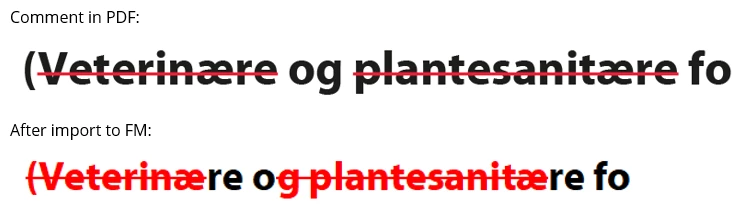

    Seems both linebreaks (shift-enter) and discretionary hyphens cause problems (could be more characters as well, but these are the first two I've encountered):
    In this sample text I crossed out "desember" in the PDF comment. In FM the word has a discretionary hyphen, so it seems to lose count of the number of characters and the comment ends up not including the "r" (1 letter short).
    All following comments are now offset by 1 character.
    The next comment (removing "endring") also has a discretionary hypen, and it has the same problem, the comment ends up 1 character shorter than it should. So now the last two comments in the paragraph are offset by 2 characters total.
    For us, this makes the feature useless. I really hope it is fixed in future updates...
