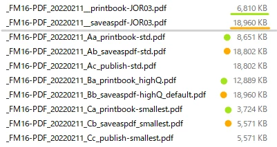

PDF file size becomes very big when generating by [Save As PDF]
I have just started using FM2020 in Windows 10.
(upgraded from FM2015, not structured, English UI, edit in Japanese and English)
When I edit files that created by FM2015 and generate a PDF by [Save As PDF] in FM2020, the file size of the PDF becomes about three times that of the PDF generated by [Print Book] (Distiller) (about 6,000 KB → about 18,000 KB, both English and Japanese).
In [Pulish]/[Setting File:]/[Outputs]/[General]/[Preset Name:], I selected the same setting as the Distiller (the same PDF job option), but the file size was increased.
I would like to generate a PDF of a similar size to the PDF created by Distiller without losing photo quality by [Save As PDF] in FM2020. It would be very much appliciated if you advise me how to set it up or any hint to reduce the PDF file size.
Thank you.

Hello Jeff,
Thank you so much for your quick reply.
My FM2020 was 16.0.1.  I updated it to 16.0.4 and generated PDF by all three ways, however, the result was the same as before...  The generating speed was almost double: Print book was around 30 sec. and Save As PDF was 60~70 sec.
I also tried to generate PDF with the same fm/book files using the preset PDF joboptions by the two/three ways, since I usually use the original joboption.  The PDF files becomes big as well.  I recheck my setting and try again next week...
*JOR03 = the original joboption
*std = standard
*highQ = high quality print
*smallest = smallest file size
5 replies

Feb 10, 2022 2:36 AM UTC
First make sure that your version of FM2020 is all patched up - there were fixes made to PDF creation (I seem to recall). The new PDFL engine is used in both the Publish to PDF and the Save As PDF routes; the Print to PDF (the Adobe PDF printer instance) still uses the older PDF distiller process. Try all three and compare results in file size and creation speed.
y.masuAuthorCorrect answer
Feb 11, 2022 2:51 PM UTC
Hello Jeff,
