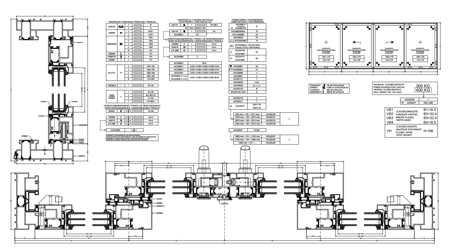

we use pdf files that we insert in framemaker to make a catalog.
when we save as pdf, certain pages (always others) showing only parts of the inserted pdf file.
how it looks in framemaker en how it should be:

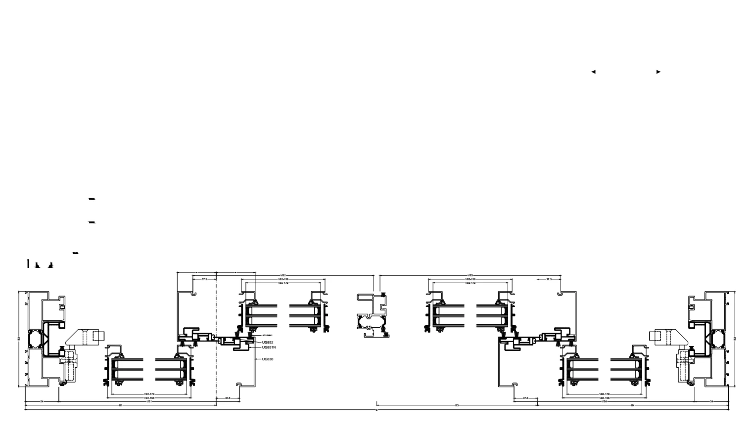

what the pdf file shows after Framemaker save as pdf:
as you see, a lot of details are missing.
Sometimes even a black shape shows in the pdf output... that shouldn't be there at all...
