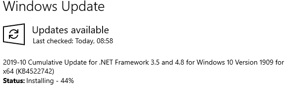

K.Daube
K.DaubeCommunity ExpertAuthor
Dec 2, 2019 2:44 PM UTC
Hi Pulkit,
After reading your post I got notice from Windows:
So I will observe the situation.
