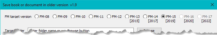

Since there is no possibility to make the label of a Radiobutton use multiple lines, I try to place the second line as Statictext below the group of radio buttons.
With this snippet
  	wSaveOld.g1.rb = wSaveOld.g1.add('group',undefined);
      wSaveOld.g1.rb.height = 15;
    	wSaveOld.g1.rb.rb8  = wSaveOld.g1.rb.add('radiobutton',undefined,"FM-08");
    	wSaveOld.g1.rb.rb17 = wSaveOld.g1.rb.add('radiobutton',undefined,"FM-17");
     wSaveOld.rbtxt = wSaveOld.add('statictext',undefined,"[2015]         [2017]        [2019]         [2020]        [2022]");
     wSaveOld.rbtxt.indent = 400;
I get this presentation:
However, I want to have the additional text closer to the radio buttons like this:
Hence in the snippet I replaced the last line by
wSaveOld.rbtxt.bounds = {x:400, y:30, width:270, height:15};
However, this has no effect at all! It turns out that only the width parameter is handled (smaller values truncate the string).
► Any ideas how to get the desired presentation?

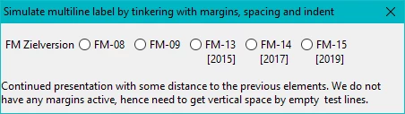

Based on the discussion in the InDesign forum, I have now found a solution:
This is, what I want to see: the second part of the lable of the radio buttons is close enough to build a unit.
PositionAbsolute = function (oObject, asProps, asMethods) { // ====================

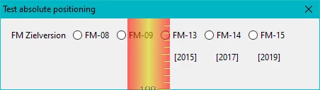

I have now created a test case to present the full code - I can not find a method to place the additional text correctly. For reference a pixel-ruler is overlayed in the screen shot:

Since "A RadioButton object has no creation properties", labels can not be multiline. Hence I try to place the "second line" close below - but no method works!
Have entered this as bug FRMAKER-12959
