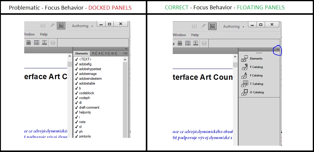

    Would you like to try if this workaround works for you:
    1. Bring the Panel in use in "Floating Mode"
    2. To make it in a floating mode: Click on the 2-small-arrows towards the top-right of a panel and make it in a bubble shape. (refer graphic)
    3. Click on the bubble to open the panel
    4. Click on the desired selection
    5. Correct Selection should now be made
