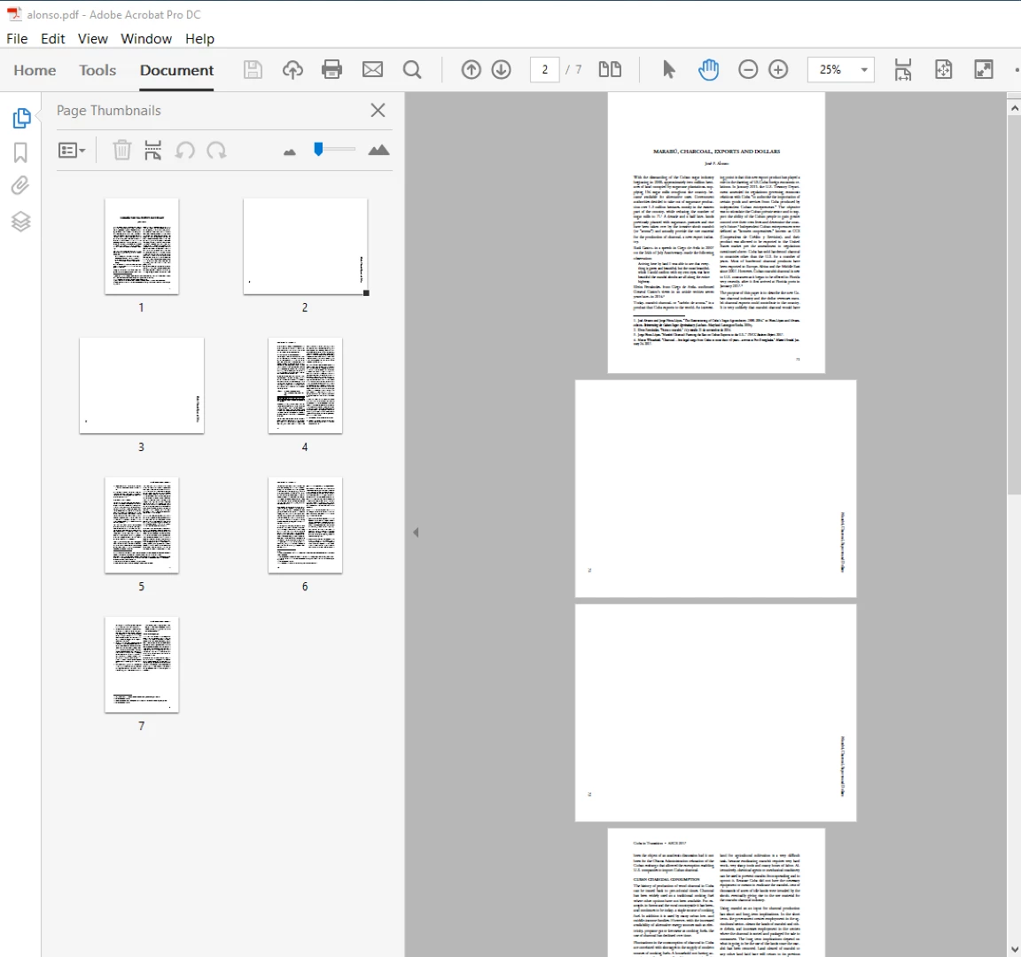

Barb Binder
Mar 8, 2018 1:51 AM UTC
HI Abby:
I have not had that experience:
Fm 2017
Acrobat Pro DC
How did you rotate the pages, and how are you creating the PDF?
~Barb
