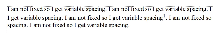

    LinSims
    Jun 7, 2021 5:58 PM UTC
    Won't it be fixed to whatever spacing you put in?
    frameexpert
    Jun 7, 2021 6:04 PM UTC
    versus this:
    www.frameexpert.com
