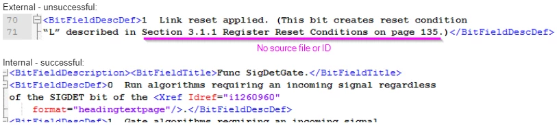

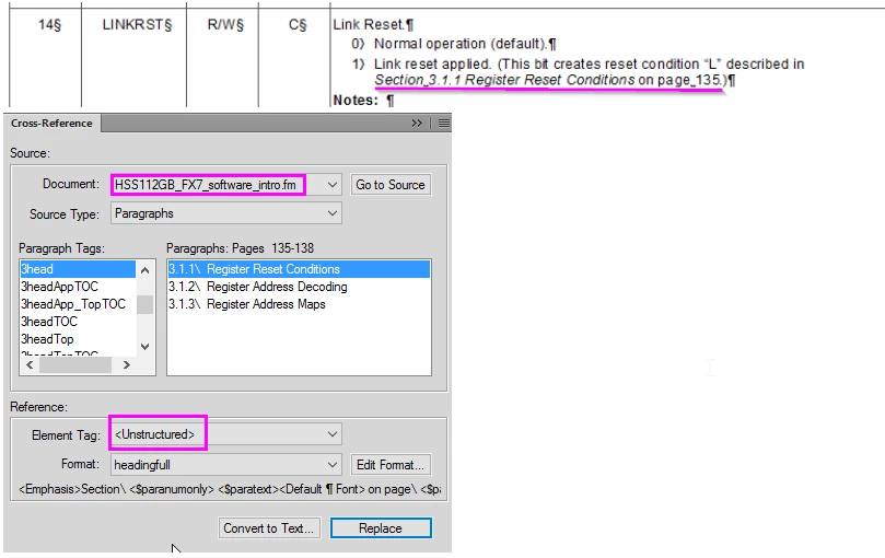

I can't get an external cross reference to appear in my XML.  I think I'm doing everything discussed in the discussion "Preserving cross-references to/from XML", but I must not be.  I start with an unstructured document with a cross reference to another document.

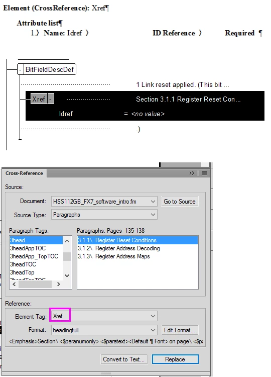

I structure the document using a conversion file and EDD I imported into the template and the cross reference appears successfully in the GUI (but there's no ID attribute,  Idref = <no value>).
When I export the XML, there's no source file or ID for external cross references, but the internal cross references are getting saved in the XML.
Where should I be looking for what I'm doing wrong?  Is it the missing attribute from when I did the conversion?
