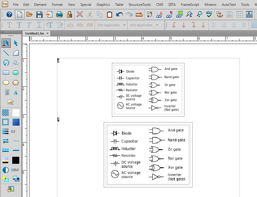

I have been using FrameMaker 6 ----> 9 for 15 years....   Ever since I started I have had a problem importing graphics.  Basically I will try to import an image by copying from another source and pasting into my FM document. Usually it is by taking a screenshot, or just right-clicking on an image from another source, and selecting "copy."  Then when I paste it in, it does paste in but it is a lower resolution than the source.  Sometimes it is larger (exploded) than the source and I can resize it to look OK but it never ends up looking as good as the original source.   I can take the exact same image and paste it into a simple graphics program, like Windows Paint, and it looks perfect, exactly like the original source.  but when I paste it into FM, it is pixelated, blurry, the wrong size (usually too large), etc...    I work on technical documents and it is important that our graphics are clear and easy to read, so this is a real problem for me (and my team).
I have attached two images.... a screenshot of the exact same image after it is pasted into Paint and then into FM:
pasted into MS Paint:
pasted into Frame 9:
as you can see it's a bit larger.   when I try to shrink it, I can never seem to get it back to the original size or clarity.
(note the version from MS Paint looks EXACTLY like the original, and I can paste into other programs like Word and it also pastes in correctly)
If anyone could help me out with this I'd really appreciate it.
thanks,
gary in vermont

    The FM image seems to be re-sampled (289x208) compared to the MS Paint one (233x168). Being a JPG, that sort of operation (that tries to add additional pixels), degrades anything that looked like lines or text. The source for this type of graphic should be using a non-lossy image format. JPG's are for photographic rendering of scenes, not screenshots or line art.  [FWIW, this example would be best served as vector graphics rather than as an image, but that's a different discussion).
    I'm not certain of what you're precisely doing in FM. I took both your images from your message and they pasted (using both the standard Paste  ctrl+v and Paste Special [both as DIB and BMP options to see if those made any differences]) into FM exactly as is. I see no change in quality (i.e. the MS Paint looks like what you posted as does the FM one that is different):
    Can you explain exactly the steps that you are doing and which method(s) for pasting your graphics into FM. Also, do yo have any third-party clipboard utilities installed?
    As a workflow, I would also not recommend using Paste to get your graphics into FM. Depending upon the source, you could also be creating OLE objects that are rendered as Windows Metafiles in FM. Also, if the content of those graphics is ever updated or you need to re-use them, then you have additional maintenance issues. Having the graphic as an external object and then importing by reference is a much more stable/predictable workflow.

    hi, and thanks for your help.
    to answer your question of how the images were created,   I have spent a lot of time trying different ways of importing graphics and I get results like this with many of them.   the images in the post are not the best example because I had to find a public image to show (I could not include a proprietary image from my work as an example).
    Here is an example of how I would typically do it in my work, that resulted in something similar as you see in the top post.
    1) Image is in another source (MS Word in the current example I'm working on)
    2) I right click on the image, select "copy"
    3) I paste it in to FM.
    4) The resulting image is resized and blurred.
    Notes:
    --there is no use of screenshots in this example.  I am just copying from Word into FM.  I am not saving or converting the image to JPG or anything like that.  just copy and paste.
    --it does't matter if the image is text, line art, or an intricate drawing created in another program and then put into MS Word before I received it.  All of them appear blurred when I paste into FM.
    --while the source in this example came from MS Word, I experience similar effects with other source, including Visio (often used by our engineers).
    --it is not really an option for us to save all our graphics as external objects.   we sometimes manipulate the image after it is in FM, adding labels, covering items with whitespace, etc, and we need it to all be flat inside the FM file. some of our documents have hundreds or thousands of images and it would be difficult to manage them all as external files.   Also our technical writing staff is not all equipped with sophisticated imaging software to manage graphics (such as photoshop, illustrator, etc).  FM is our graphics tool.  It has served us well for the most part (except for this copy/paste issue) as many of our graphics are schematic line drawings and the FM tools are good for this.
    --I have tried many ways to copy images into FM, including taking screenshots, going through a graphics program between the source and FM, and others.   Sometimes I am surprised and it works OK but most of the time I have this blurring/exploding effect.   I have not been able to find a method that works consistently.
    --I have experienced this problem on multiple computers and with multiple versions of FM, over a long period of time.
    Perhaps there is some kind of real/good reason this is happening, but I think it is a problem.  I have used many other documentation programs such as Word, Open Office, ... and if I copy an image from another source into the document, it appears exactly as it did in the source.   I see no benefit of FM resampling the image, with a simple copy/paste.
    thanks

    September 9, 2014
    > ... I am just copying from Word into FM ...
    1. In Word, select the image.
    2. Right-click Save-as-Picture
      .tif
      to some file path that FM can find, filename temp.tif.
    3. In FM, File > Import > File
      some file path and temp.tif
    4. Copy into Document
    Delete the temp.tif when the document is complete. This avoids the damage caused by using the clipboard, and, as desired, you still end up with space-consuming embedded graphics that have no history as to where or when they came from or where else they might be used.
