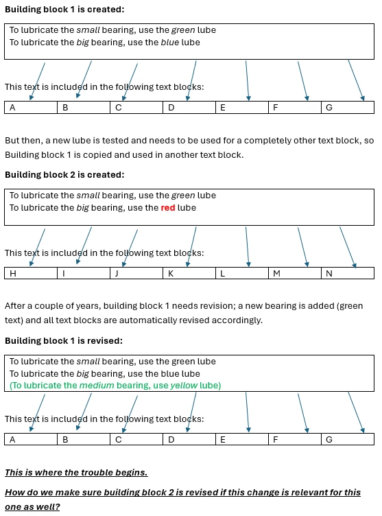

Building block 1 is created:
To lubricate the small bearing, use the green lube
To lubricate the big bearing, use the blue lube
This text is included in the following text blocks:
A
B
C
D
E
F
G
But then, a new lube is tested and needs to be used for a completely other text block, so Building block 1 is copied and used in another text block.
Building block 2 is created:
To lubricate the big bearing, use the red lube
H
I
J
K
L
M
N
After a couple of years, building block 1 needs revision; a new bearing is added (green text) and all text blocks are automatically revised accordingly.
Building block 1 is revised:
(To lubricate the medium bearing, use yellow lube)
A
B
C
D
E
F
G
This is where the trouble begins.
How do we make sure building block 2 is revised if this change is relevant for this one as well?
