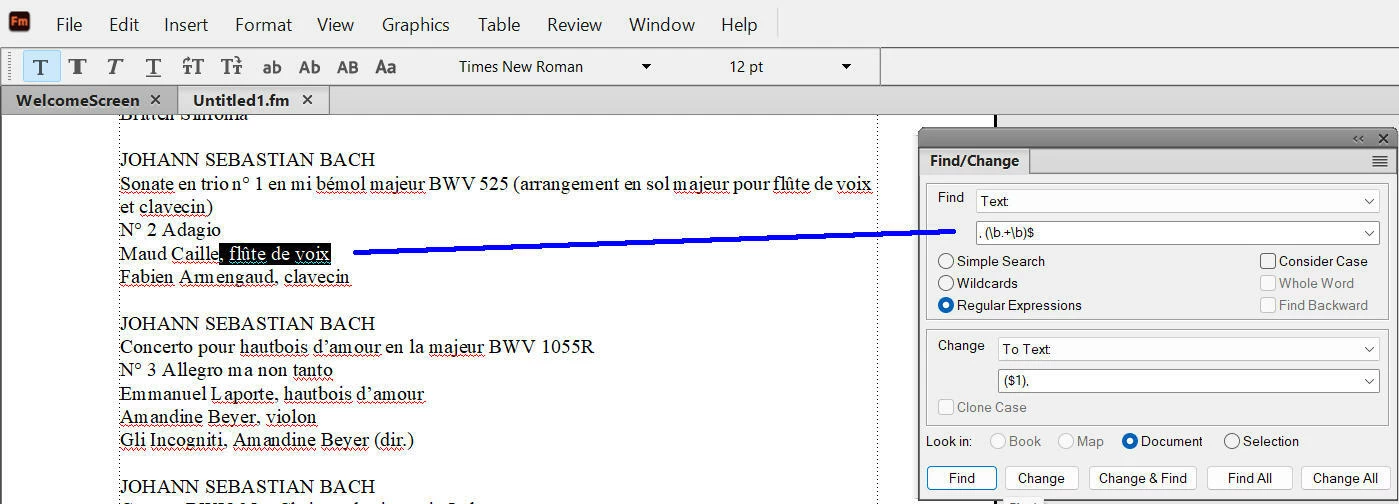

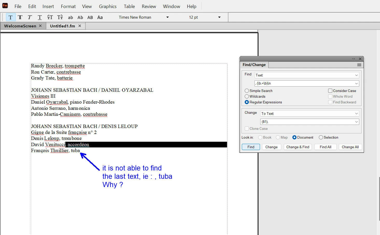

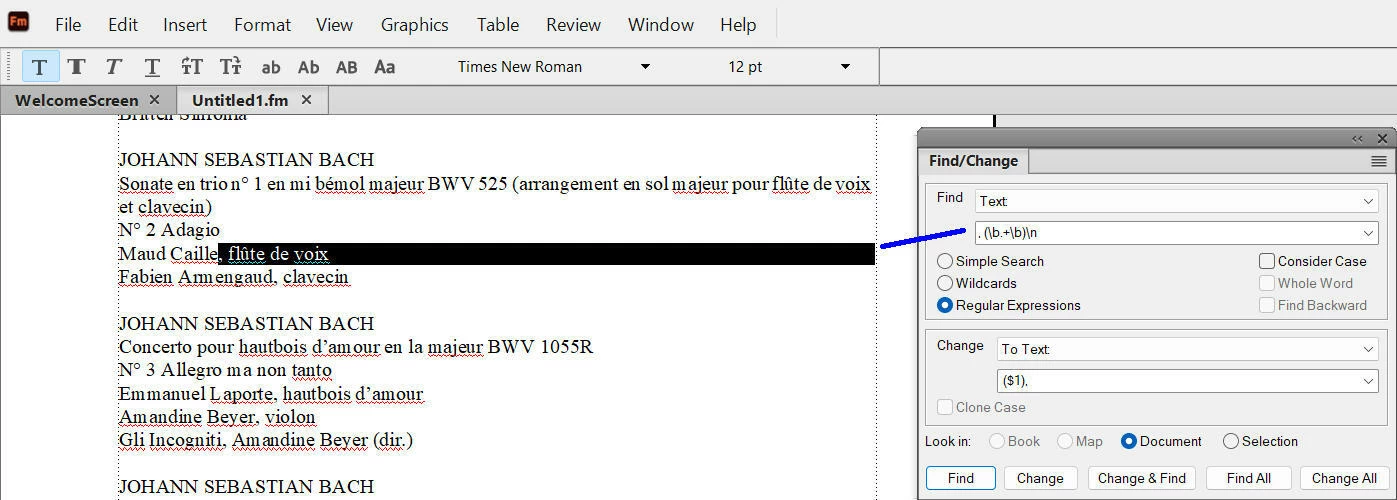

My regular expression is :
, (\b.+\b)\n
 ($1),
In this document all is working well except for the last line (see blue arrow) where it is not able to find the last text, ie :  , tuba
Why ?

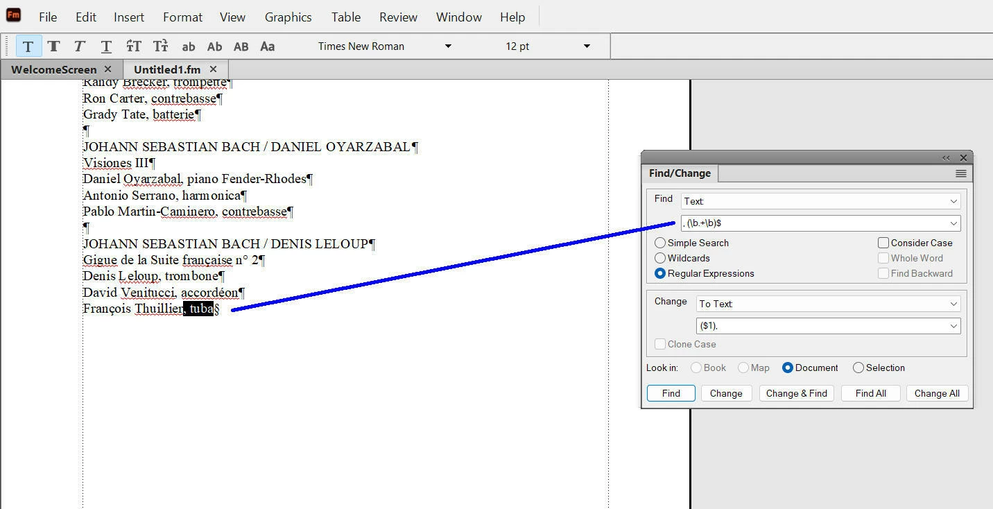

    Jul 3, 2026 3:39 PM UTC
    ​@frameexpert
    I have a problem with the change in the regular expression from \n  to  $  :
    ---  If I use   , (\b.+\b)\n   (like before),  I have this :
    ---  If I use , (\b.+\b)$  I have this :
    The problem is that by doing “find” I need to remove also the space after “flute de voix” in order that the next line will be automatically added after “flute de voix”.

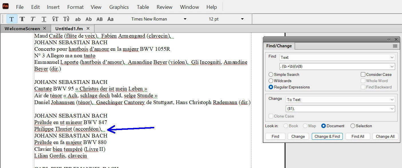

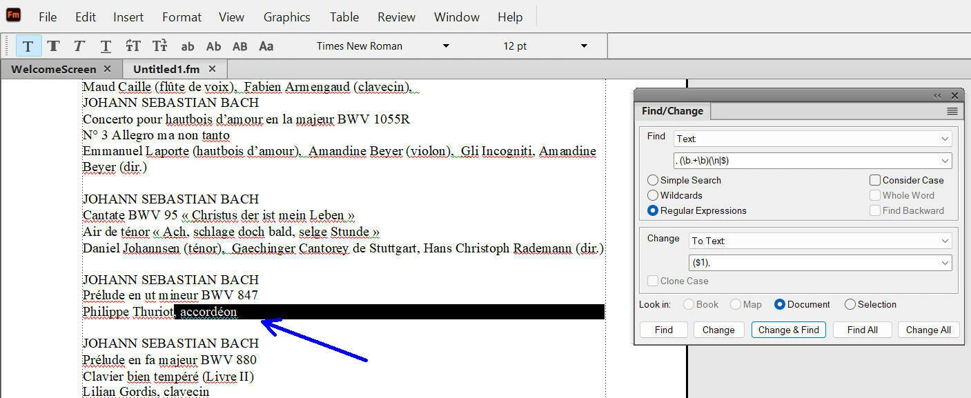

    Jul 3, 2026 8:52 PM UTC
    ​@frameexpert
    I have tried this :
    , (\b.+\b)(\n|$)
     ($1),
    It works until the end, but I have a little problem when there is a blank line after :
    Before the change :
    after the change :
    In this example, after “accordéon” there is a blank line, and the result after change  is :
    (accordéon),      so there is a comma and the blank line is removed.
    But  I would like something like :
    (accordéon)       without the comma and by keeping the blank line after
    In that case, what regular expression I can use ?
    Jul 3, 2026 3:16 PM UTC
    Here is the page with the text symbols.
    ​@Jeff_Coatsworth  :  if I add a blank line after   , tuba : it succeed to find  , tuba   .   Why am I obliged to add a blank line after in that case ?
    ​@frameexpert  : by replacing   \n with $ : it works.  In order to understand, why have you choosed  $  instead of   \n   in that case ?
    frameexpert
    Jul 3, 2026 3:35 PM UTC
    \n means new paragraph and you don’t have a new paragraph after the last line. $ means at the end of the line.
    www.frameexpert.com
    frameexpert
    Jul 3, 2026 1:09 PM UTC
    Replace the \n with $ and see what happens.
    www.frameexpert.com
    Jeff_Coatsworth
    Jul 3, 2026 12:47 PM UTC
    Can’t tell exactly since you don’t have text symbols turned on, but what happens if you add a new paragraph after “, tuba”?
