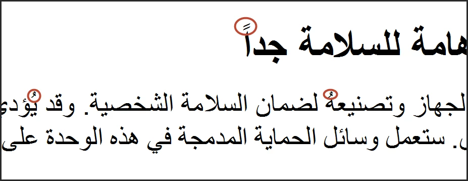

Arabic Language has special letter typing called "Arabic Diacritization" for example the in the below pic. (The Pic from FM)
The problem is when i type such letters in arabic and get print the .fm file, the result in the PDF is shown as below pic.
The New Version of FM 13 is really good in handling such language like arabic, but i want to know why this ONLY issue still exist in the Version (Even after update).
the characters that include the arabic diacritics is breaking in the baseline. and this totally wrong in arabic language.
so if you know anything can help or plugin or script to solve this issue, as this way of type in arabic can change the meaning in language.

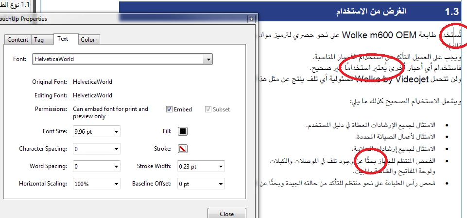

I tried many fonts to solve this issue in FrameMaker 2015 and found that the font Helvetica World solves it. It makes the Arabic text with diacritics appear correctly after printing to PDF format. The font is free online. It also has all the weights: regular, italic, bold, and bold italic. Below is a screenshot from a test file:@
Hope this helps☺.

thanks very much for your useful reply, and i test it really and found that the font is near for the arial font too. but in arabic it solve all the kind of problem.
again thank you, you are the Prof. in this field and you will be always

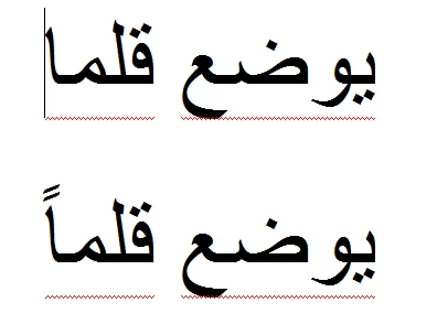

thanks for your kindly reply, i want to show you Jeff_Coatsworth about what exactly the diacritics, please see the below screen in illustrator ME version
they are letter putted on the Main letter in the Arabic, something like the French language, but i think that every language have it's special characters.
for Mike-Hardy, i would explain that the problem is not in the main Baseline, but it's when i use the diacritics letter in arabic and print PDF.
in Framemaker 2015 the Letter shows that they are correct and no problem, i used Arial font as it's the Font system and it's support all kind of typing. (see screen below.)
then when i'm printing i found that the problem is the letter have diacritics letter is show as broken, (as the picture below from 1st post.)
and tried to print in PDF and choose many job option in printing, the problem is still exist.
so i think the problem in the engine of the FM, OR it could be from the printing setting that i can't solve it.
waiting your Fast reply guys. and thanks for help.

Umm, ok – I kind of get what you’re talking about with the concept of a diacritical mark, but I’m still fuzzy as to what’s busted. You say that in Illustrator they are correct – what happens when you create a PDF out of Illustrator? Is it correct or broken? Is it appearing correctly in FM2015 & is only busted when you print to PDF? Or is not showing correctly in FM in the first place?

No, they working fine in All adobe products except FrameMaker 2015.
I just made them on Illustrator to explain in more Clear Pic.
So, do u have any solution about the diacritical mark ?
