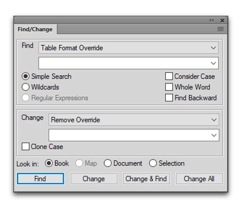

    Barb Binder
    Oct 10, 2017 5:15 PM UTC
    Tables will come in with overrides. You need to remove the overrides before they will pick up Table Designer formatting. A super-easy way is Edit > Find/Change. Find: Table Format Overrides, Change: Remove Overrides.
    Here is an alternative solution:
    Adobe FrameMaker: Removing Table Overrides - Rocky Mountain Training
    ~Barb
