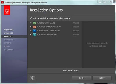

I have to deploy Technical Communications Suite 3 to a group of 20 people with a volume license key.  In order to avoid giving 20 people in the company a volume key, I'm using the Adobe Application Manager to build a distributable silent installer for this delivery.  The problem is that when you use the Adobe Application  Manager to create the build, Adobe Acrobat Professional X (which is part of the package) is not an installable option, nor is it actually installed as seen in the attached screenshot

This is true that Adobe Application Manager Enterprise Edition currently does not support silently deploying Acrobat alongwith TCS3. However, you do not need a separate license key for Acrobat.
Pls follow the below mentioned steps to silently install TCS 3 with Acrobat:
1) Uninstall TCS3 (including Acrobat) from your machine, if already present. Make sure all products are uninstalled succesfully.
2) Create a serialized package for TCS 3 using the AAMEE tool
3) Run the silent installation command for TCS3
4) Goto the Exceptions folder inside the TCS 3 package and open ExceptionInfo.txt. This has information of all the products that this package will not install. Look for the command to install Acrobat X Pro. For your reference, I am mentioning it here,
msiexec.exe /i AcroPro.msi EULA_ACCEPT=NO REGISTRATION_SUPPRESS=YES SUITEMODE=1 TRANSFORMS=en_US.mst INSTALLLEVEL=101 AS_DISABLE_LEGACY_COLOR=1 IGNOREAAM=1 /qn
5) Install Acrobat silently using this command
6) Launch any product installed through TCS ( FrameMaker or RoboHelp) and verify that its activated (Help->Deactivate menu should be enabled)
7) Now launch Acrobat. You will see that Acrobat automatically picks up TCS 3 license present in the machine and gets serialized. You do not need any other serial number.
