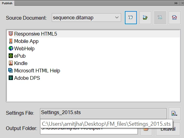

    Hi Nancy
    In FM 2015 (also in FM12) the publish settings (.sts) is a separate file. You can reuse the settings file to publish multiple document and share across machines just as other files. You can hover on the settings file to see the full path of the .sts.
    You can browse other settings files by opting open in change settings button just right to the settings File.
    Currently user need to browse the shared settings file to use your settings.
    Please let us know if you face any issue.
    Thanks
    Amit Jha

    Jeff_Coatsworth
    Dec 2, 2016 2:53 PM UTC
    Yes you can call it whatever you want - use the little edit icon you see beside the "Settings_2015.sts" part of the screenshot that Amit posted. You can do a "Save As" inside of that to name the default.sts to whatever you want.
