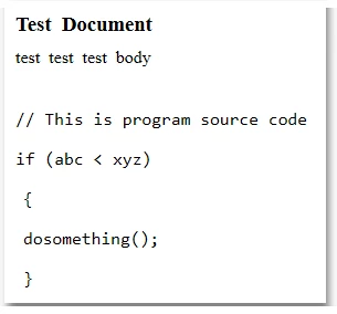

When I publish to HTML, the indentation is messed up:

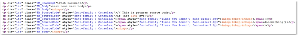

This is what the HTML markup looks like. I drew a box around the weird span that is generated to represent the tabs:
Why is that span in there? Why does it use inline styling to override the font family and size? How are tabs supposed to be handled in the publishing output?

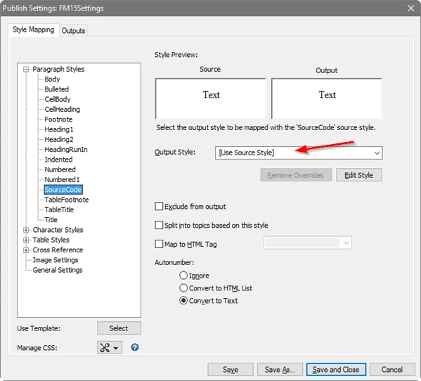

If I change the settings to not map the SourceCode para format to PRE, and instead use "Use Source Style"

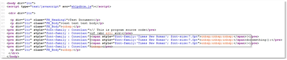

Then this is the HTML output:
Which also contains the unwanted span, plus unwanted inline styling for the font-family. Why didn't it put the font-family into the FM_SourceCode CSS class?

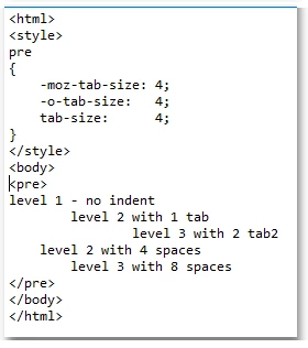

Here is a simple HTML file that shows how it could be done with a PRE tag and some CSS. The width of the tab would need to be a parameter to your conversion. In this case, it is set to 4. Or, you can leave it up to the user to provide their own CSS.
Which produces this output in the browser:
