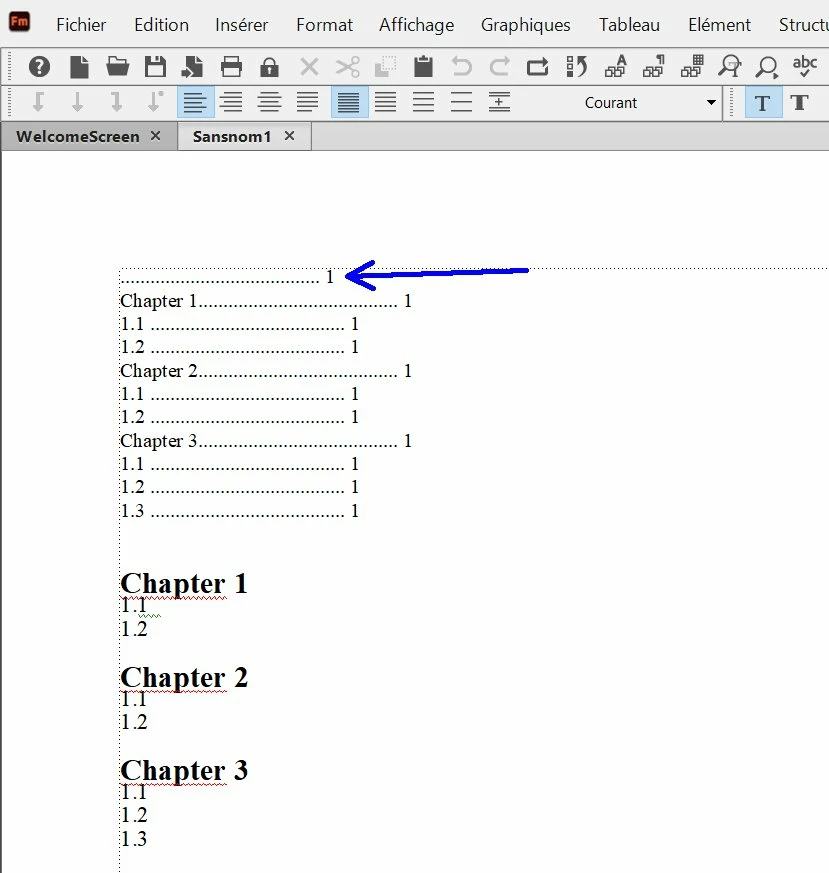

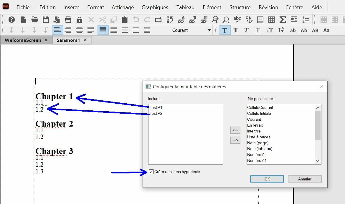

I have created two paragraph style :
- Test P1 (for Chapter 1, Chapter 2, etc ...)
- Test P2 (for 1.1 ,  1.2  , etc ...)
And I have created a Mini TOC with :
- Test P1
- Test P2
- Hypertext link is checked

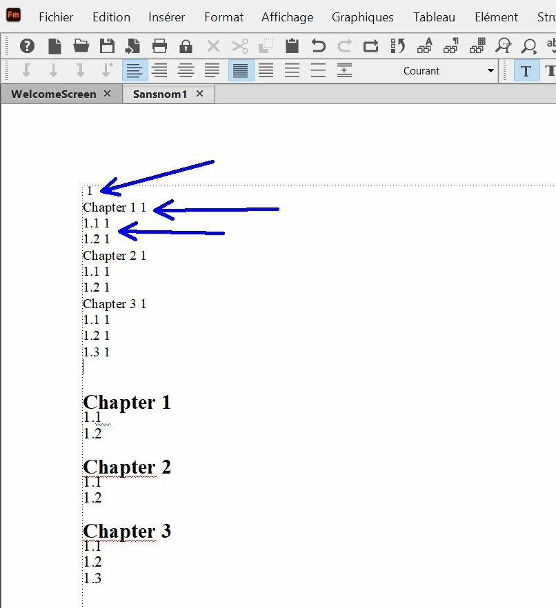

But here is the result :
- FM add a number "1" at the begining of the MTOC
-  FM add a number "1" at the end of each line
- I have no hyperlink inside the MTOC

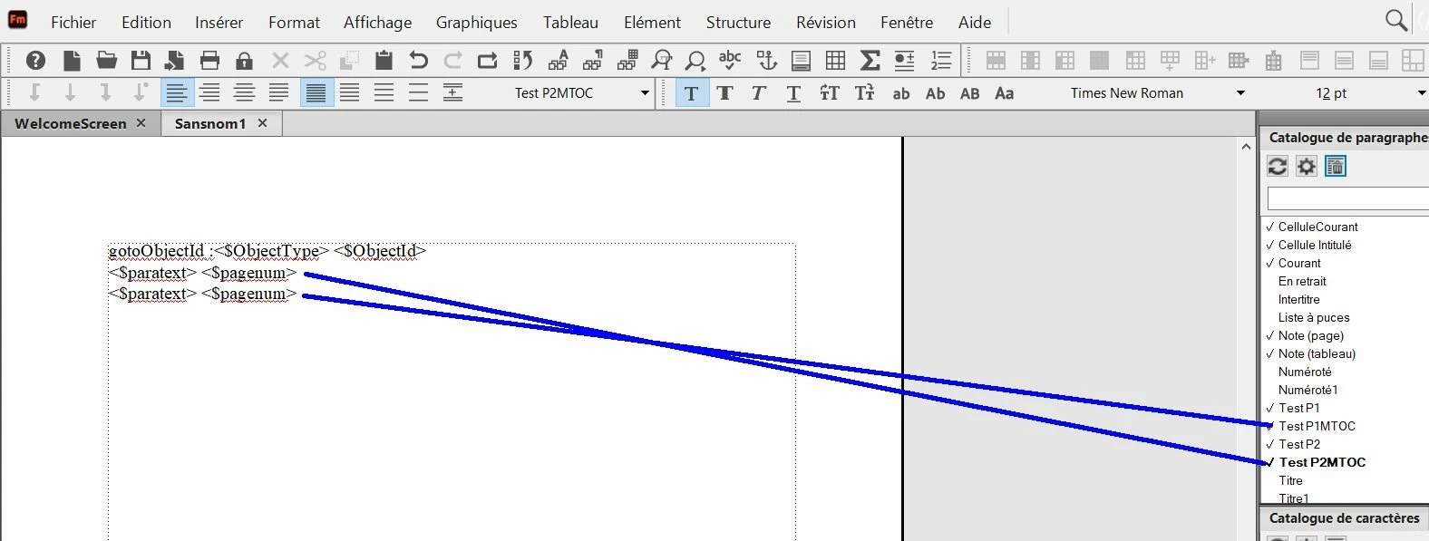

And here is what I have in page reference :
Why do I have this result ?

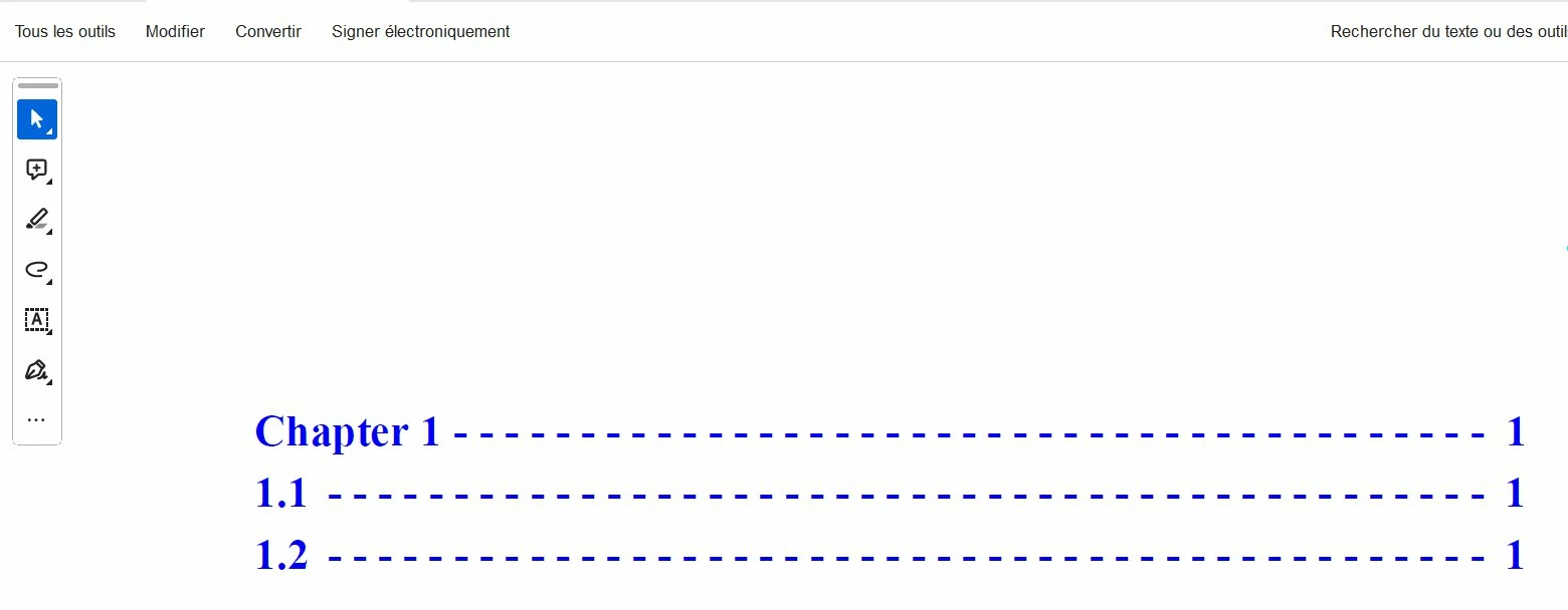

So you are working on a 15" laptop. When I see your videos on youtube, it is like if you had a more big screen. Is it because you have changed its resolution ? And what software do you use to do your videos : is it Captivate or other software ?
Barb Binder
June 6, 2024
Hi Pierre:
This is what I see when I open your file—without doing anything at all:
I'm thinking it is a screen display issue on your end. Try zooming in, File > Print or File > Save as PDF. Do you see the blue/bold leaders after any of those steps? I didn't find any overrides so I think FrameMaker isn't sharing an accurate display.

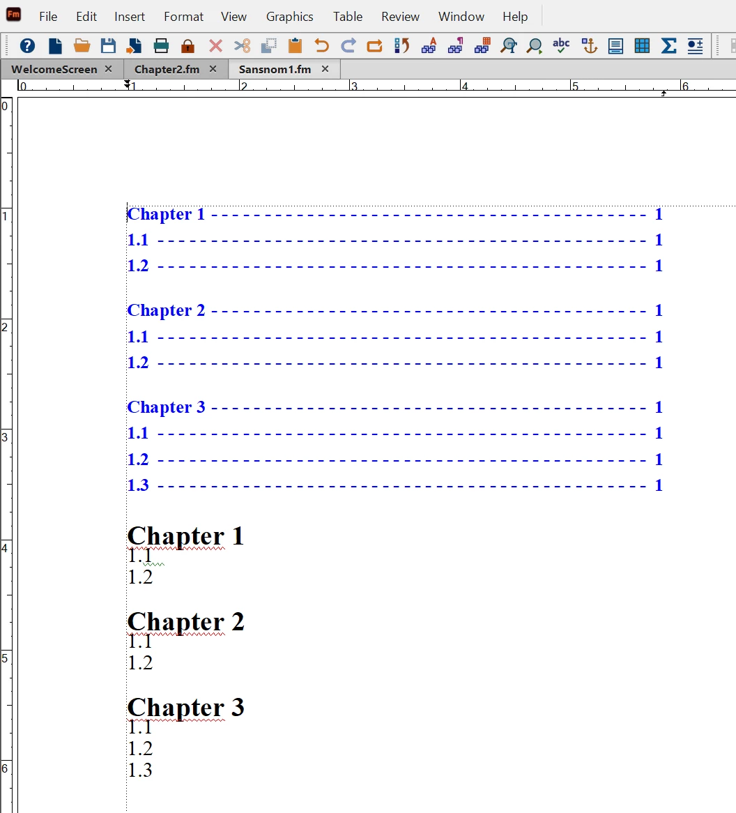

June 6, 2024
Hi Barb,
With FrameMaker I am working on a 15" laptop at a zoom of 110%, and here is what I have :
You are right ! By changing the zoom by example to 190% , I have this in FrameMaker :
And with the sam zoom (190%) in Acrobat Pro :
Do you think the cause is that I have a too small screen, or are there some display issue ?

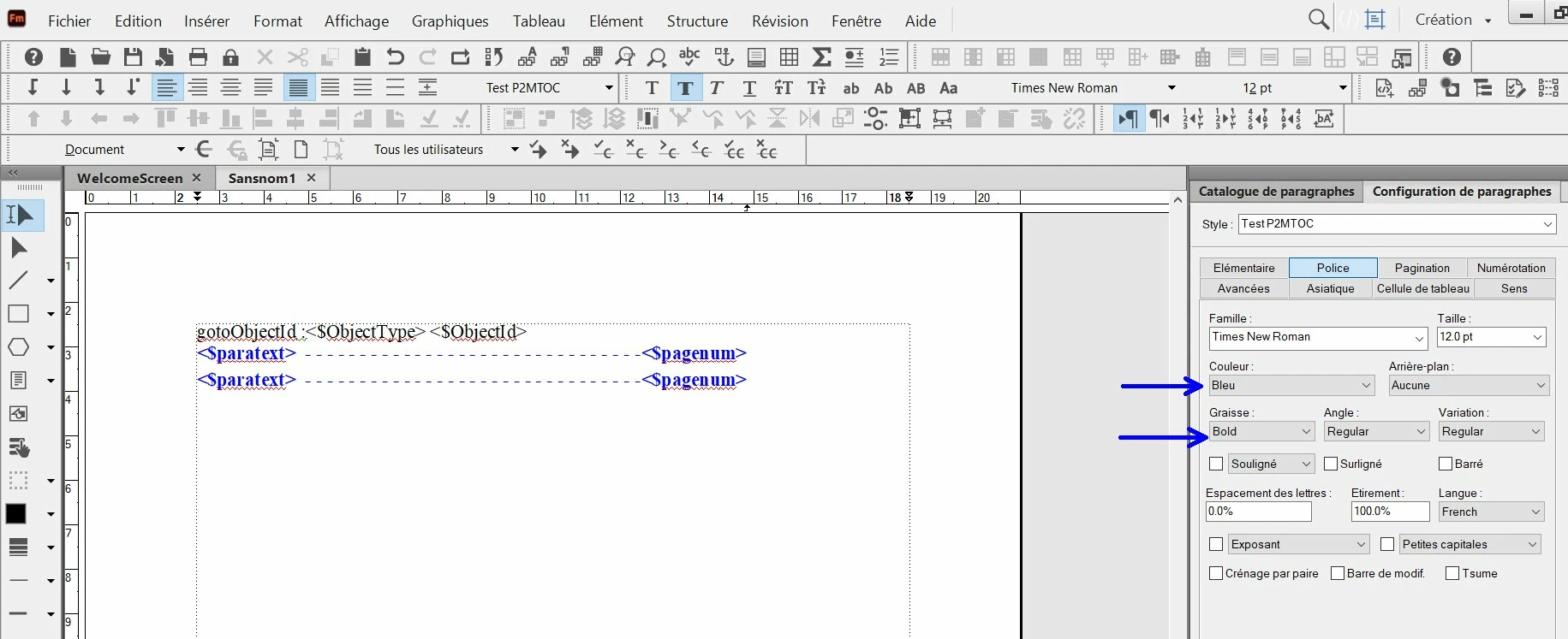

Hi Pierre:
You can add the blue color to the paragraphs, or just to the page numbers.
  • If you add it to the paragraphs as a paragraph style, you can do it either on the body pages or the reference pages.
  • If you want to add the blue to just the numbers, you can select them on the reference page <$pagenum> and assign a character style. Something to be aware of though, is that if you add a character style to a paragraph, the only clickable area will be within the character style. That means readers wouldn't be able to click the text and follow the hyperlink. They have to click on the colored page numbers.
Now, let's look at your first screen shot in your last post. You are very close. Double click the tab arrow you are pointing at below the ruler, change the alignment to right (first column), add the leaders (second column) and adjust the tab position. This is adding an override so be sure to update the paragraph style once you like how it looks. (That's why the body page didn't update in your second screen shot.)
Repeat for the other paragraph style, update the paragraph style and then update the MTOC.

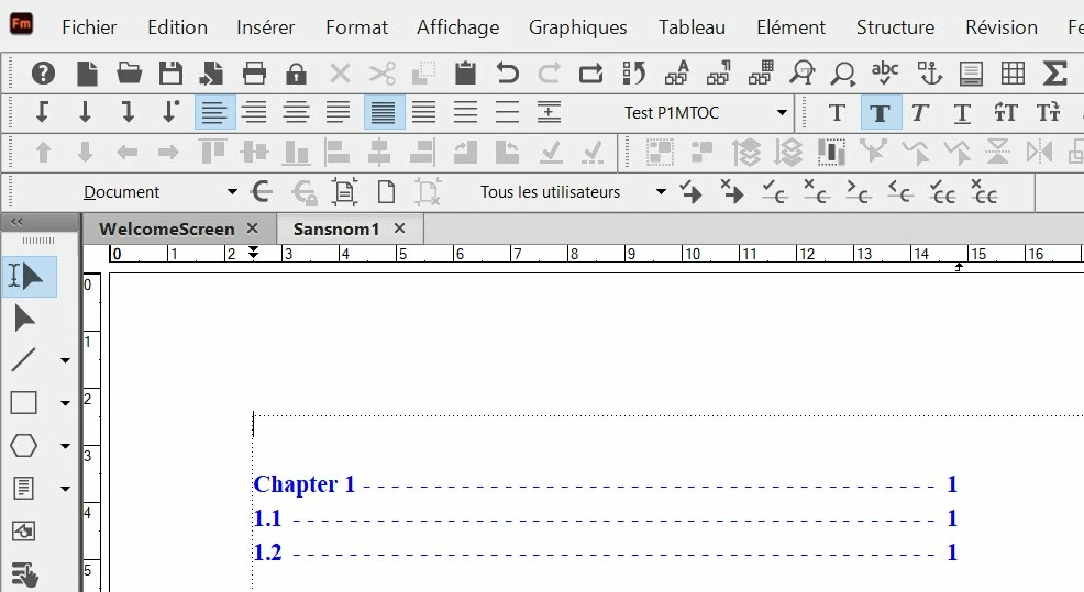

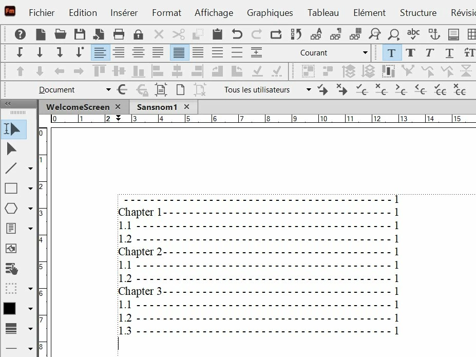

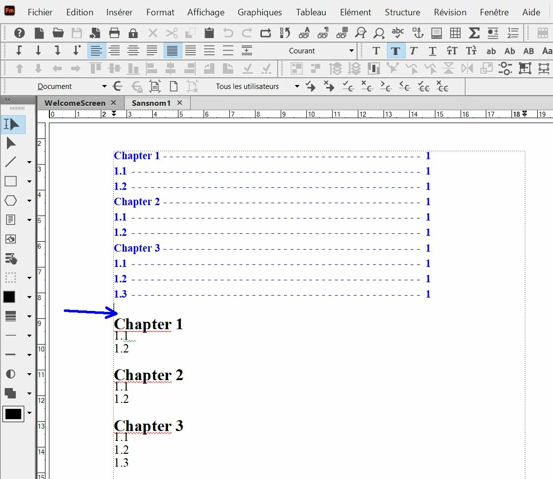

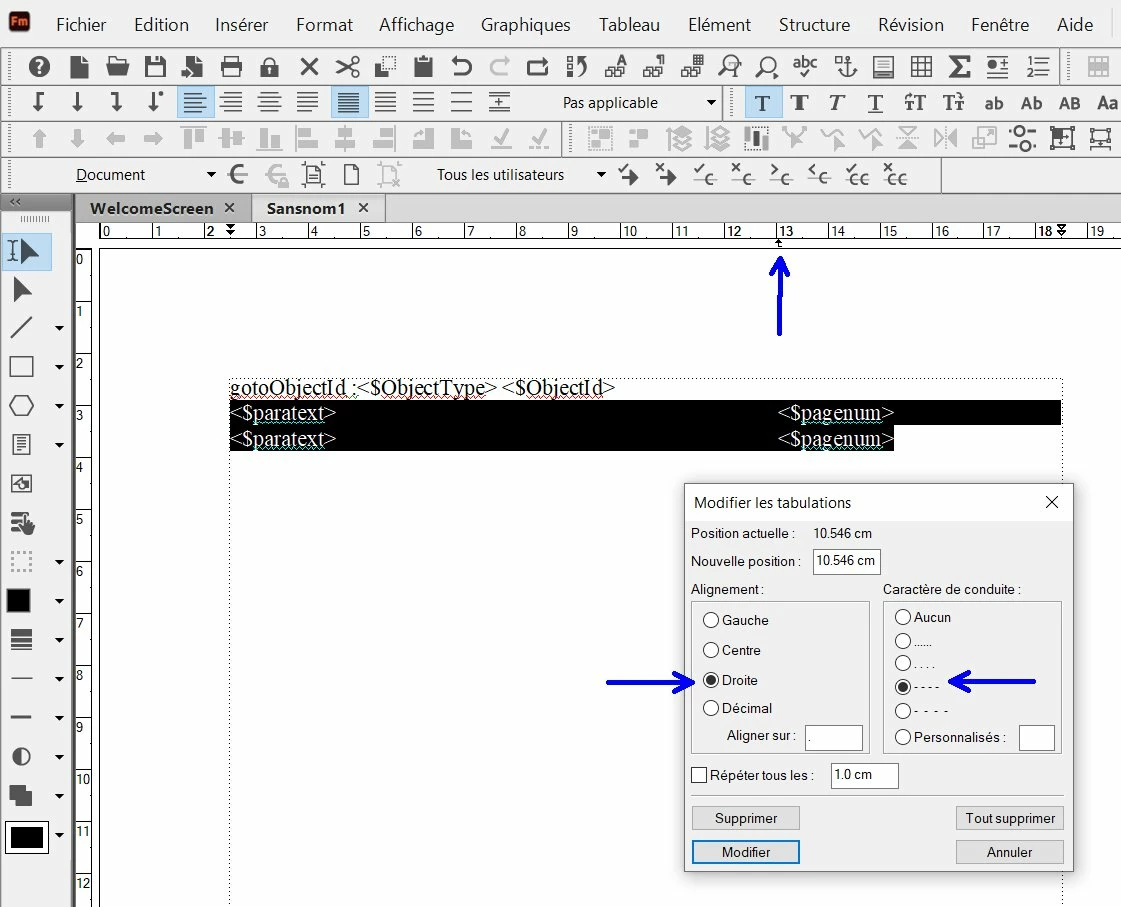

June 5, 2024
Hi Barb,
In References pages, I have selected the two lines, and clicked on the top ruler to select a tab stop for the two lines.
Then I double clicked on the top ruler tab stop, and selected right (in left column) and the leaders (in right column) :
Result in References pages :
And I have updated the paragraph style in reference page for each line.

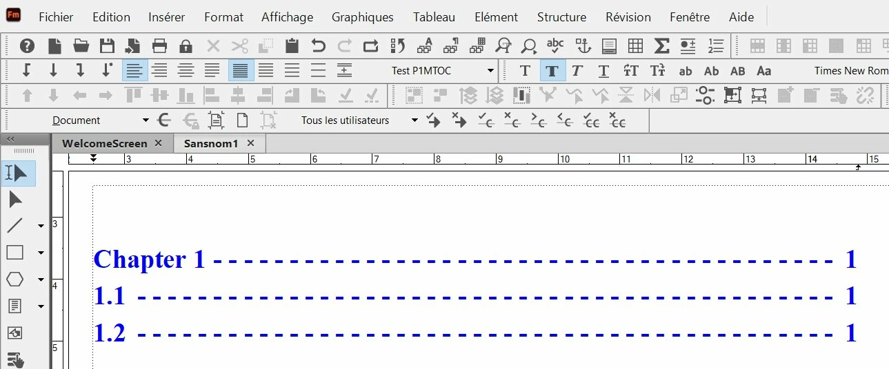

The result in body page :
Now, about the blue color, in reference page I have set the font in paragraph style (for each line) on "blue" and "bold". But I see that only paratext and pagnum are in bold blue (the leaders are only blue but are not in bold. Why ?) :
I updated paragraph style in page reference and here is the result in body page :
Finally, I have removed the paragraph symbol at the blue arrow, so here is the final result (the begining of the MTOC does not display the page number "1") :
And about the drink (mix of chicory and cereals), I give you the manufacturer page (it is made by Nestlé) : https://www.nestle.fr/media/pressreleases/caro-devient-ricore-cereales-chicoree
As I cannot drink coffee and tea, I have found this drink, and I think it is better for health. And I don't taste the chicory (chicory is at 14%).

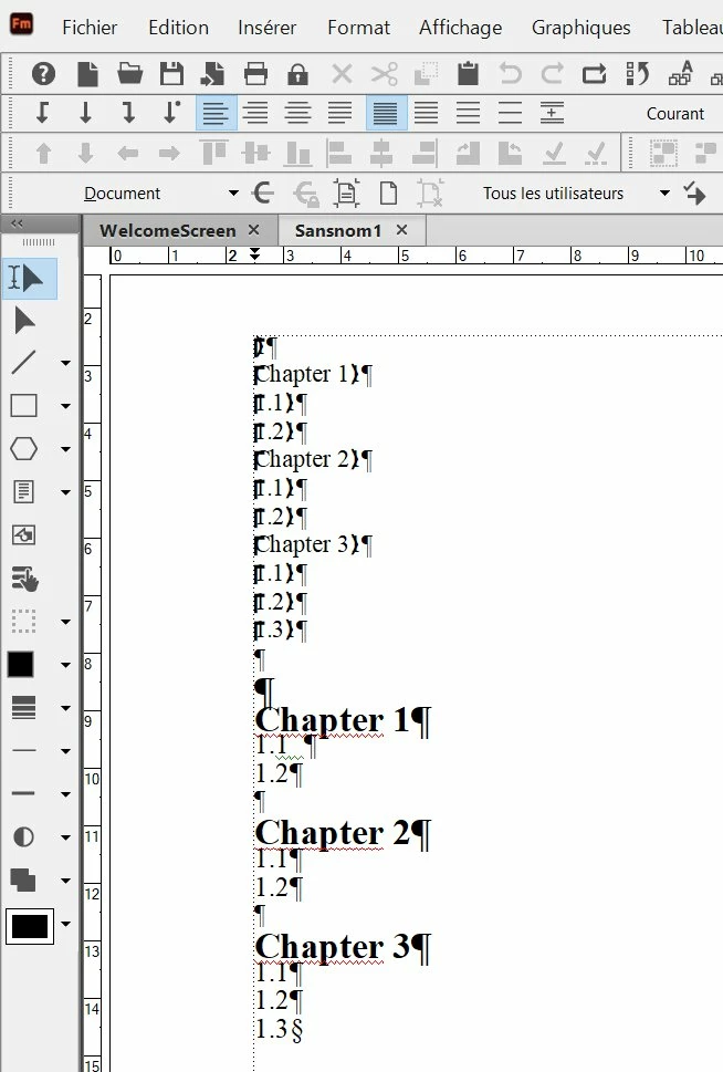

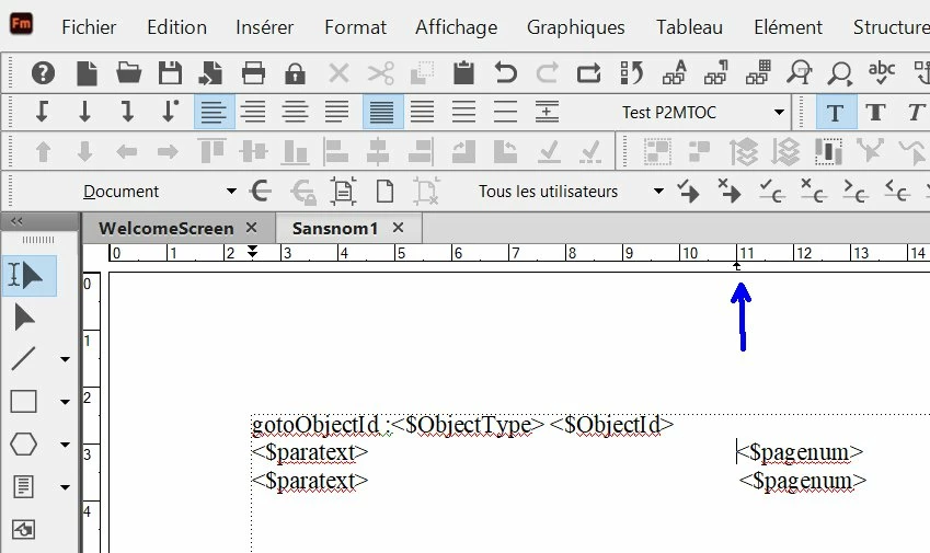

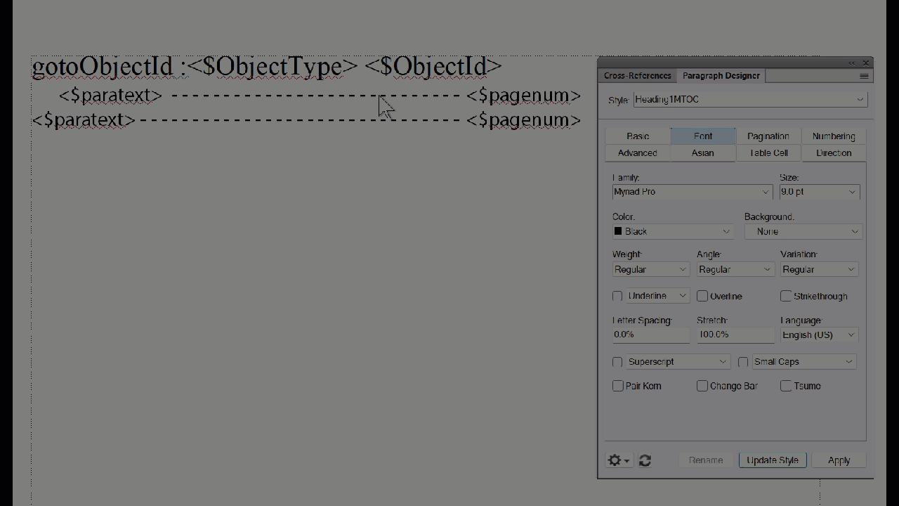

June 5, 2024
Hi Barb, Hi All,
Oh I see ... 9 AM at Evergreen . Here in France it is 5 PM. Personally, the morning I take a hot drink that is a mix between chicory and cereals.
About FM, in page references, I have removed the points (made by using the keyboard), so I have no space between paratext and pagenum, and I have added a tab stop by clicking in the top ruler for each line :
And here is the result in the body page. You can see also the text symbols :

Barb Binder
June 5, 2024
Nice! I was typing while you were posting, so now it's down to the empty ¶ on the body page.
Are the hyperlinks working after the update? Are you testing them by holding Ctrl + Alt as you click on one?
If not, please share that last screen shot again after you remove the ¶, but with text symbols showing.
~Barb
Barb Binder
June 5, 2024
Salut Pierre!
Thanks for starting out by showing us your reference page—that's the issue, of course. You results look confusing but Fm is doing what you are asking. The 1 at the end of the lines is the page number. Fm defaults to spaces between text and page numbers, you need to replace it with a tab and set the tab stop.
TestP1MTOC should look like this:
<$paratext>\t<$pagenum>
where \t is a tab character. You can type in the \t or just press the Tab key on the keyboard. In either case, you will need a right-align tab stop defined for the style.
TestP2MTOC should look like this:
again, you need to remove the space and add the tab. Then set the tab stop.
The 1 at the very top reflects that empty ¶ at the top of your first screen shot. No text, so Fm is just showing the page number. Head back to the body pages, View > Text Symbols to see it, and then remove it.
After making these changes, right click the MTOC on the body pages and update. This should straighten out the presentation. Let's deal with the links after it looks the way you want.
~Barb

frameexpert
June 5, 2024
It looks like you have an empty paragraph above your Chapter 1 heading paragraph. It has one of the paragraph formats in the Include list applied to it, and that is why you get an empty TOC paragraph with just the page number.
