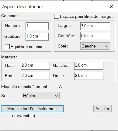

In Frame Maker for my FM document if I go in Format/page layout/columns, I have set a margin of 2 cm :

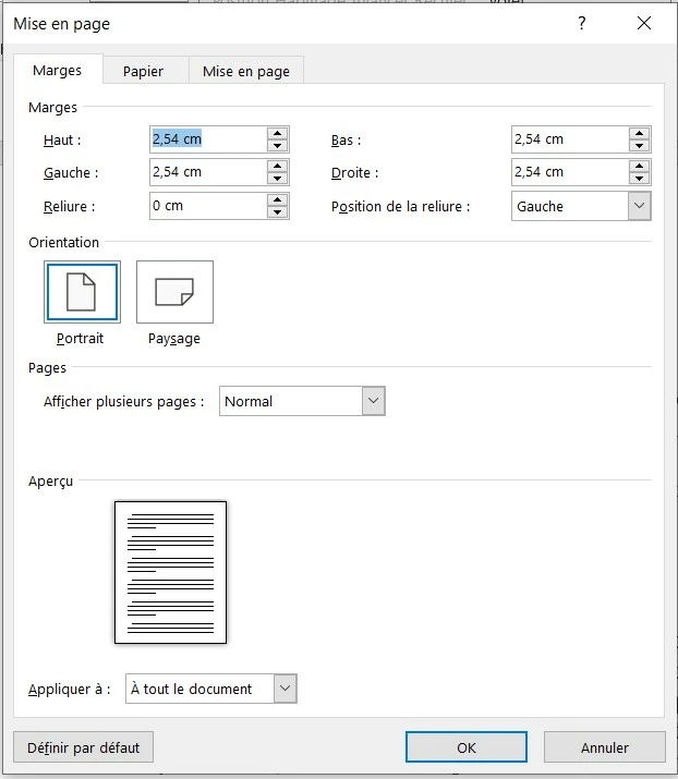

But, if I copy/paste the text of my FM document to Word, and if I go in the Word page layout, I have 2.54 cm as settings for the margins :
Why a margin of 2 cm in FM becomes a margin of 2.54 cm in Word ?

If you are using the clipboard to copy/paste text from one program to another, it won't have any affect on either program's page layout settings.
