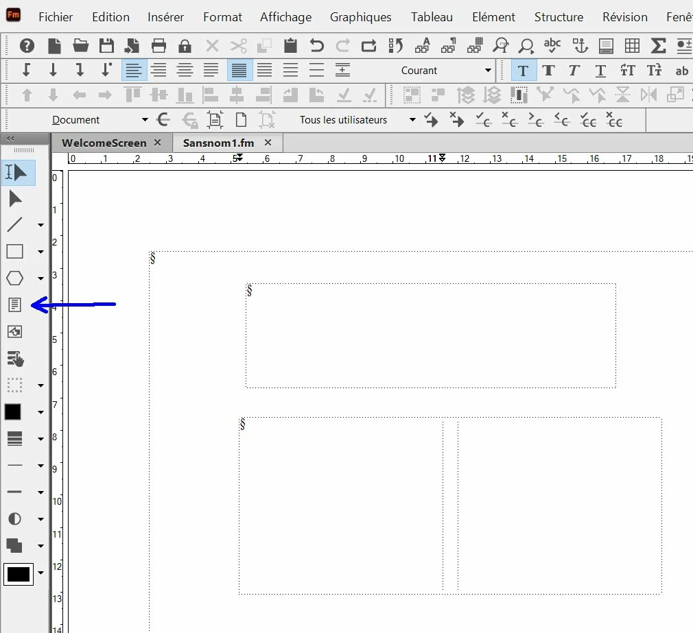

I am trying to make a layout inside Frame Maker, by putting several text frames inside the page (with the text frame button at left). But I don't see any smart guides between these text frames : by example, if I want to align two text frames, I would like to see some smart guides between these two text frame.
How to see these smart guides ?

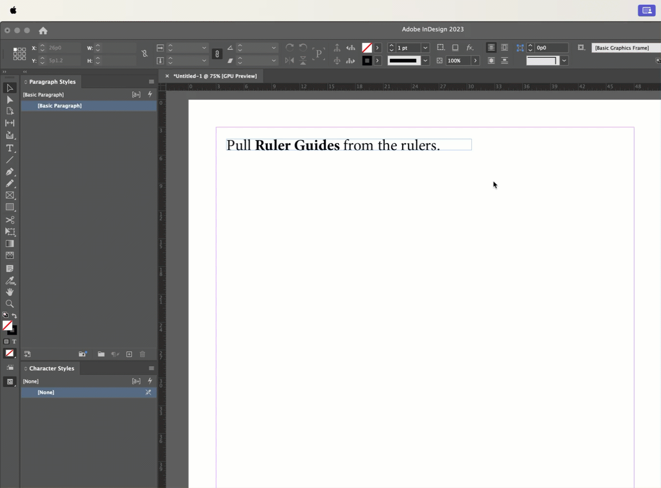

Barb Binder
May 6, 2024
Smart Guides are part of the Creative Cloud applications and differ from Ruler Guides which we pull down from the rulers. Both are alignment aids. Neither are in FrameMaker.

May 6, 2024
Hi Jeff,
with "text symbols" ON, I have only this symbol inside these two text frames, but no smart guides :
