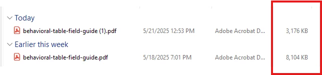

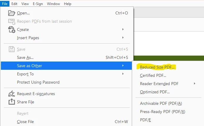

    You could try opening the PDF with Acrobat Pro and use Save As Other > Reduced Size PDF and see what you get. It's an extra step, but it may give you a good result. I just tried it with a PDF and got a pretty good reduction.
