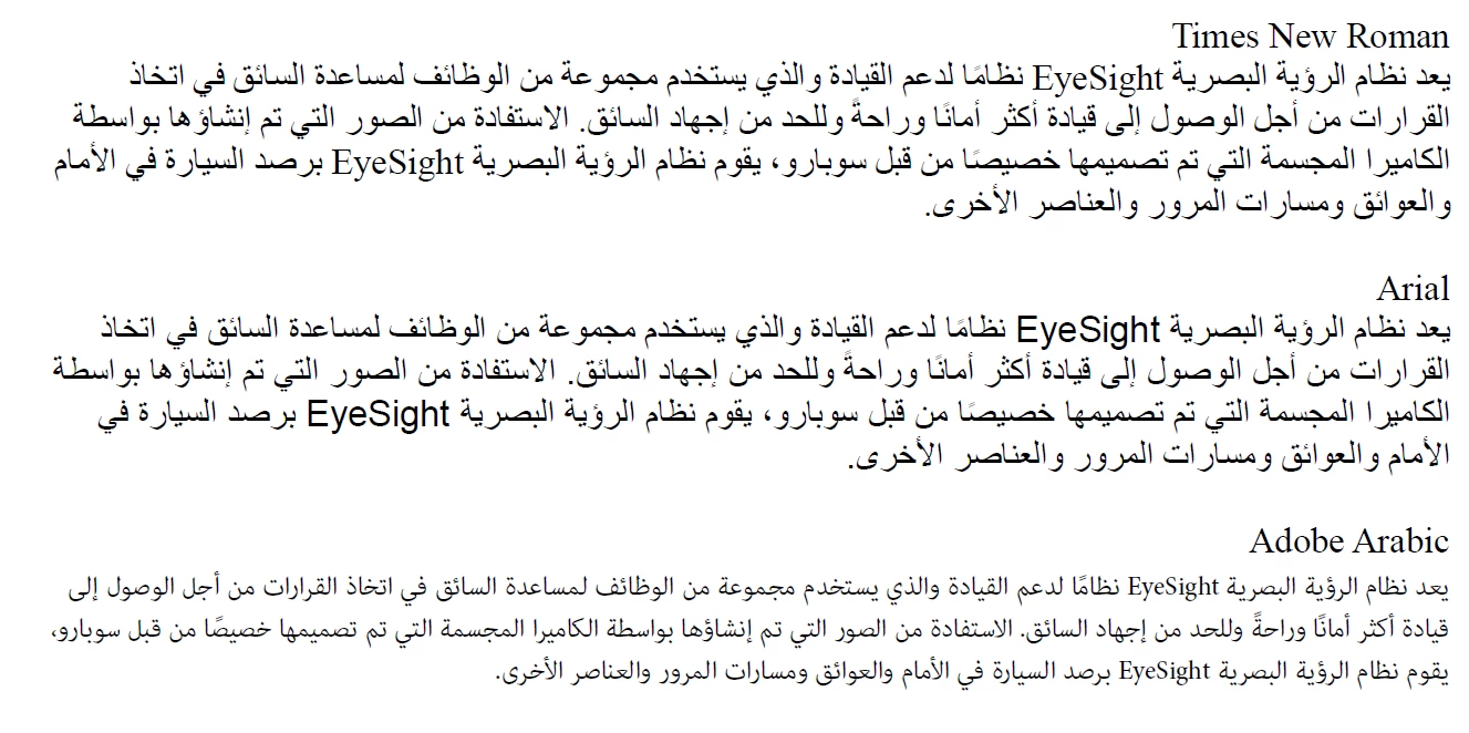

    I have copied your sample paragraph to FM 2015 (13.0.5.547) three times and assigned Times New Roman, Arial and Adobe Arabic. Shows fine in FM:

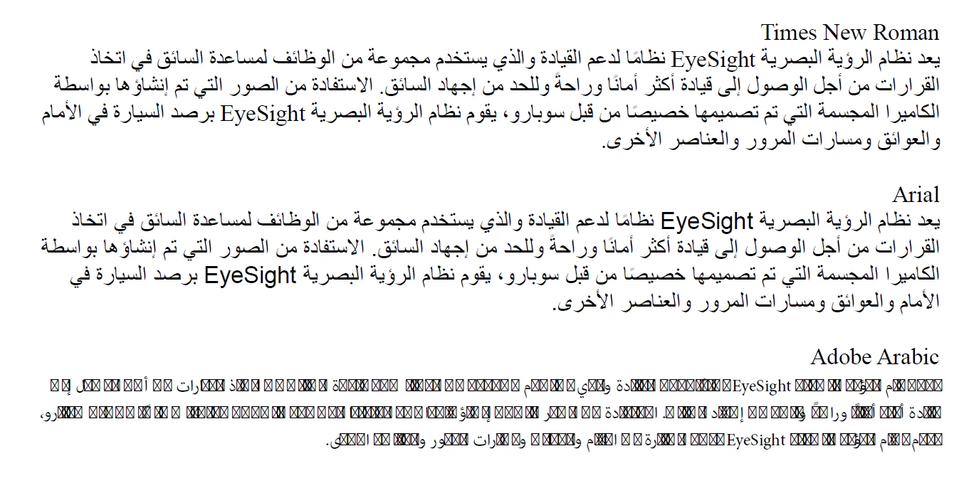

    But when I create a PDF, Times New Roman and Arial work fine, But Adobe Arabic is wrong like in your example:
    I then tried to go the "traditional" route and printed the file into a postscript file (> File > Print) and ran it through Acrobat Distiller.
    Then it was fine in the PDF:
    Also, I have tried it in FrameMaker 2017 and there both the print to ps / Distiller as well as the Save as PDF route work and produce a PDF where also the paragraph formatted with "Adobe Arabic" works fine.
