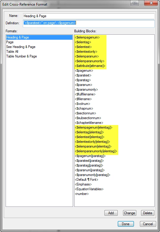

Typically, in a FrameMaker cross-reference, you do not directly specify the test that you want to appear as the cross-reference text. You use building-blocks in your cross-reference format that will determine which text from the target will appear. For example, the <$elemtext> building block displays the target element's text as the cross-reference text.
If you want to specify your own text that may be different from the target, you could use the <$attribute[attrname]> building block and specify the desired target text (for example, "actions") as an attribute value. In this case, you could have an attribute on your target element called xref-text. Then the building block for your cross-reference format would be <$attribute[xref-text]> and you would leave it out of your <ref> element.
Here is a list of possible building blocks with element and attribute types highlighted. If you need further help setting this up, please let us know. Thanks.

Your <ref> element is correct, except the link_text attribute doesn't go on it. It will go on the target element that has the matching id of "group__ip__class_1gaad23d5c191f1ede03638140cb21ca31f".
