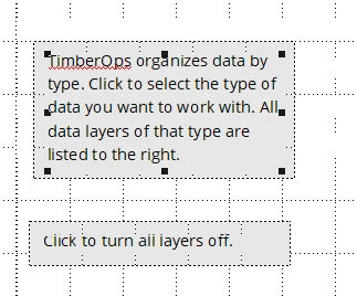

I've searched and found a few articles about replicating callouts from MS Word, so in general I have the impression that I need to use text frames to create them. I spent some time fiddling with settings, because I want the background colour to be grey. I got that, but it's very tight to the text, which I don't like. I want a surrounding area of grey. I found that I can add this by putting the text frame into an anchored frame, and literally using the anchored frame like a picture frame to give me more surrounding grey. I've attached a picure that shows the boundary of the text frame within the anchored frame. Hopefully this clarifies what I'm explaning.
Question 1: Am I missing a setting on the text frame that let's me create a larger area around the text that will also get the background colour?

I would avoid the extra frame. Just use the text frame with left and right indents on the callout paragraph. To get the top and bottom offsets, use small Frame Above Pgf and Frame Below Pgf spacers that you create on a reference page. Make sure these frames are transparent so that the gray background that you apply to the text frame shows through. Multiple text frames can be selected and aligned (unlike unanchored frames).

Perfect.
If I'm honest, I'd forgotten all about the reference pages. It turns out the default table footnote works alright for this.
