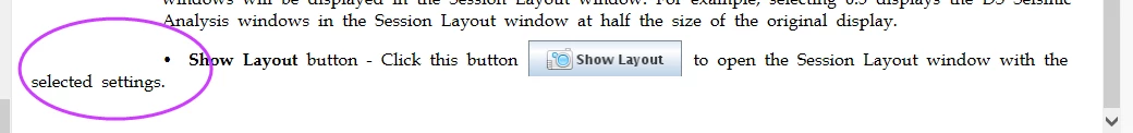

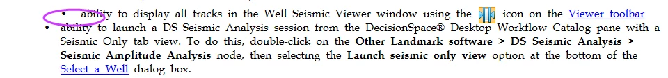

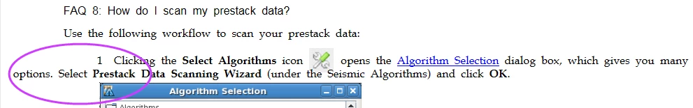

When an image e.g. icon image, appears in a paragraph or bullet, the indentation gets messed up. The source file is fine if I generate a PDF to check the results are fine but with the Responsive HTML 5, the indentation gets messed up.
Examples of html 5:
I have tried changing the line spacing but that has not helped. I have tried decreasing the icon image so that it's dimension match the text but that has not worked either.

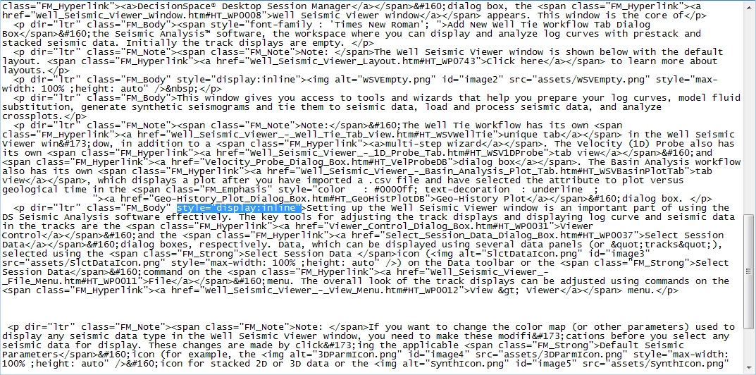

I looked up the code of my html files and have found a tag that is added each time an image is added anywhere. When i remove this piece of code, the indentation issue is fixed. But this will not work for me as my help consists of thousands of topics.
Piece of undesired code:      style = "display:inline"
