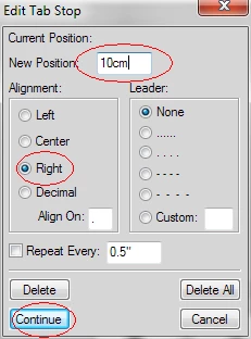

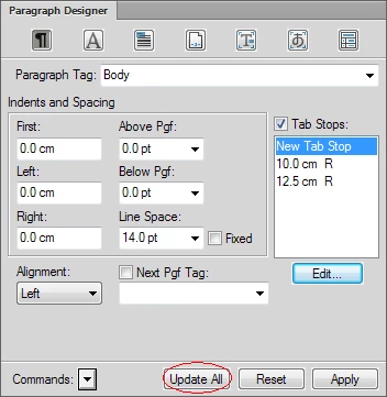

    In the Paragraph Designer for your TOC tag entry, on the Basic tab, select the New Tab Stop entry and then click the Edit button under the Tab stops to get the Tab defintion panel.
    Now enter the position that you calculated and select the Right Button and then click Continue to define the tab stop.
    Now define a further tab for the page numbers at the right edge by repeating the previous steps using the value of the right-margin for the tab stop.
    Finally, click on the Update All button of the Paragraph Designer to permanently set the tag with these tab stops.

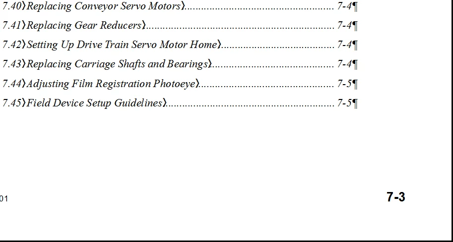

    cbdunn70
    Jan 24, 2013 11:33 PM UTC
    Klaus,
    Do you need a specific distance to the left? If not, you can simply place the chapter number variable to the left of the page number. They will both be right aligned, but the chapter number will populate to the left. Just keep enough room in the page number frame you have on your Master Page to allow for double-digits (or triple... depending on how long your document is) as the page numbers increase. I use a hyphen to separate the chapter from the page number. It looks like this on a right-hand page (below).
