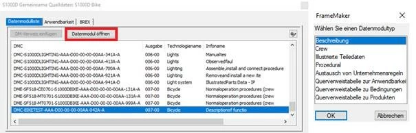

Hi, we are using FrameMaker2019 Release for a (quite big) S1000D project. We are in the conception phase and have 2 main problems.
Creating description data module by using the function common source data
Creating a data module the normal way works fine. The problem occurs if we try to create a new description data module by using the function common source data. If we choose any other data module type than the crew module noting happens and the window closes. But this function is necessary for our project to manage the data modules. Is this a bug?
