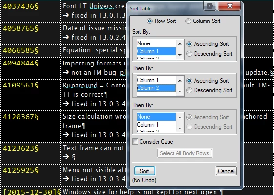

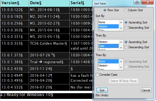

Hi, Lohith,
I do not understand Your question, because there is the menu Table > Sort:
I have set in the dialogue to sort at first by the first column, then by the second. If there are no heading rows then the drop-down list mention the columns by "1st column" etc.
