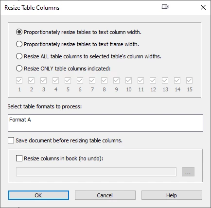

frameexpert
Nov 23, 2022 1:03 PM UTC
This is the absolute, essential guide. I recommend printing it out and trying the examples.
https://creativepro.com/files/kahrel/indesign/scriptui.html
ScriptUI is for making nice interfaces for your scripts. Here is a dialog box from my TableCleaner script, written with ScriptUI code:
