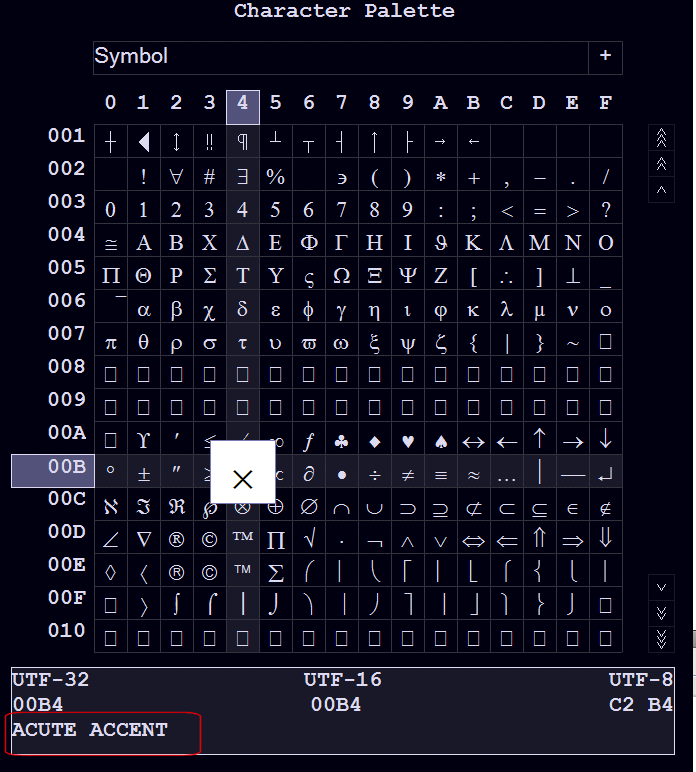

    Another weird strange thing I found is that the character pallete in FM9 is really screwed up.  If you mouse over a symbol, it is supposed to give you the name and hex code of that symbol at the bottom.  However these are all wrong.  When I mouse over the multiplication symbol, it says it is an "accute accent".  In fact all the symbols are named wrong.  I have no idea if the hex codes are also wrong.  here is what I mean:
    What the ....?
    I don't really care that much if the names are wrong, as long as it works, but it is strange that they would all be wrong like that.
