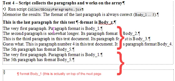

Strange behaviour at bottom of page
Friends of FrameMaker and ExtendScript!
With my script Convert Footnotes to Endnotes I got weird results and hence stepped back to the simpler case of just copying paragraphs.
Collect&CopyParagraphs.jsx does what the name says: copy paragraphs from the beginning of the document at the end.
To see what is copied the source paragraphs have format Body_1 … Body_5.
The script works fine as long as there is enough space towards the bottom of the page:
The first run of the script produces the output indicated by the upper brace.
The second run produces a mutilated output indicated by the lower brace.
The output of the third run can not be recognised, you only notice flicker on the bottom line.
The script, however seems to run correctly. The logging (see file test4-3times.log) of the 3 runs is identical.
→ What is going on here?

frameexpert
frameexpertCorrect answer
Jul 16, 2019 6:26 PM UTC
You problem is likely line 18, because the last paragraph in the first text frame might not be the last paragraph in the flow. You may want to use a function to get the last paragraph in the flow.

frameexpert
Jul 16, 2019 5:02 PM UTC
Klaus, can you post a link to your test document. Thanks. -Rick
www.frameexpert.com
K.Daube
K.DaubeCommunity ExpertAuthor
Jul 16, 2019 5:06 PM UTC
Rick, the fm document is in the mentioned zip: https://daube.ch/zz_tests/Test4.zip .
Klaus Göbel
Jul 16, 2019 5:13 PM UTC
Hi Klaus,
your script works so far.
If you increase the length of the page, you'll see.
You have to consider a pagebreak;
