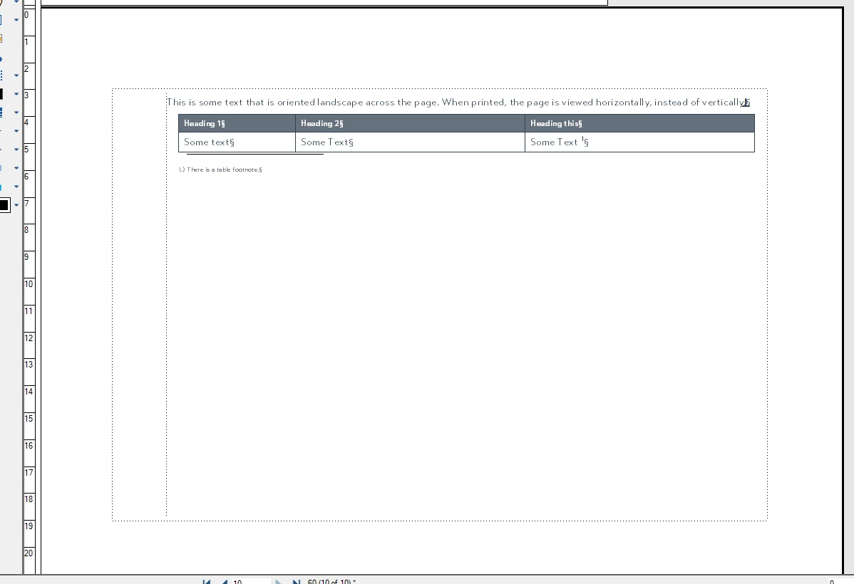

I have a table footnote on a landscape page. In FM, when I view the page, the text for the table footnote appears correctly:
When I rotate the page to work on it, it also appears correctly:
However, when I Save as PDF/Publish to PDF, the text on the footnote is rotated:

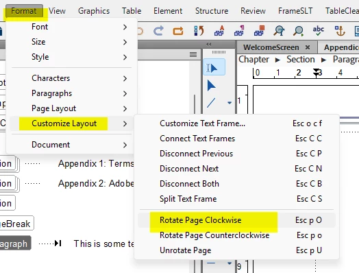

    How do you "rotate the page?" Do you mean rotating the textflow? I have just tried that and was unable to reproduce the error.

    @FrameMaker-dk ,

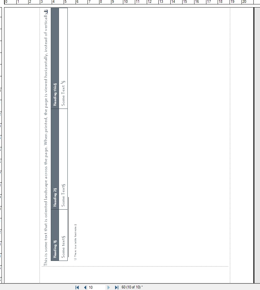

    I set up a Master Page with the text frame rotated 90 degrees so the text is oriented landscape across the page, like so:
    I then rotate the page, so it appears onscreen like a landscape oriented page:
    I do this because it's easier to read the content that way.
    Once I'm done, I "unrotate" the page again.
