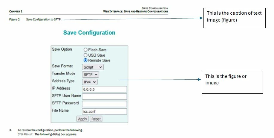

As per the technical writing established practices, the caption of a figure and a figure must be on the same page.
After publishing in Adobe FM, We have a customer’s complain about cross referenced images and their captions not being on the same page. I am running Structured FM ver 17.04.628.
I have assembled a pdf file showing this not happening after using crossreferenced images – see Test_crossref_2.pdf, Chapter 2 (attached).
The file with the detailed explanation is attached – see file Captions_dont_go_on the same Page_as images.pdf.

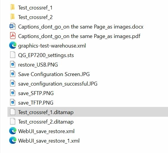

 I have all files compressed in a .7z file but this format of file is not supported. Xml files are also not supported. Upon request, I will send all missing files in an email. The list of the files needed is shown  below.
