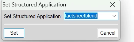

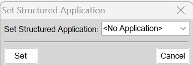

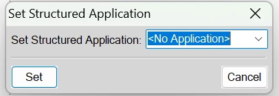

With the template opened, in StructuredTools > Set Structured Application…, when I try to set the structured application root element:
the root element appears in the look-up menu:
But when I select it, it does not accept the new root element that I selected:
It will accept one of the existing root elements in the menu:

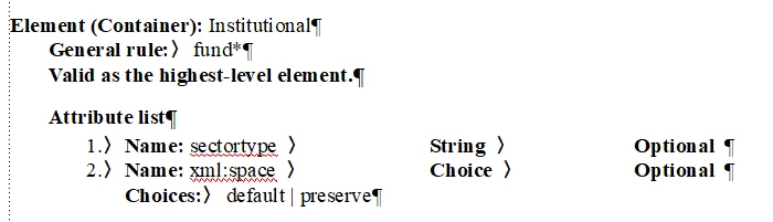

Does your EDD specify the desired element as Valid at the Highest Level?
www.frameexpert.com
Aug 18, 2025 3:18 PM UTC
Yes. Here it is:

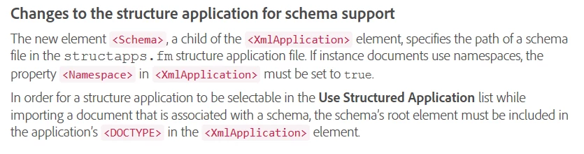

Hi, I haven't worked with these configurations for a long time. And your version of FM is quite old, so I can't really say exactly what is the expected behavior. But I was thinking that it might have something to do with the DOCTYPE specification in the application definition. Maybe you already considered that. I found the following in the help related to XML Schema, but maybe it applies to DTD applications as well. It speaks of the dialog box that appears when opening a markup file, but maybe the concepts are the same. I can't replicate the behavior, but I am using a newer version of FM so I don't know. Hope this helps, maybe at least some.  -Russ

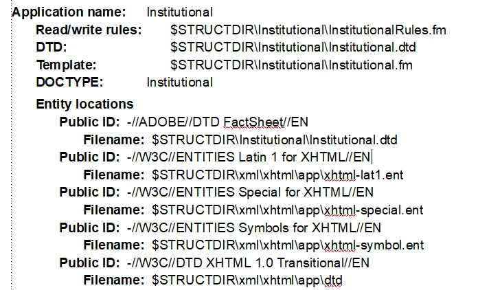

Thanks for the response.
This is how it is set up in the structapp:
