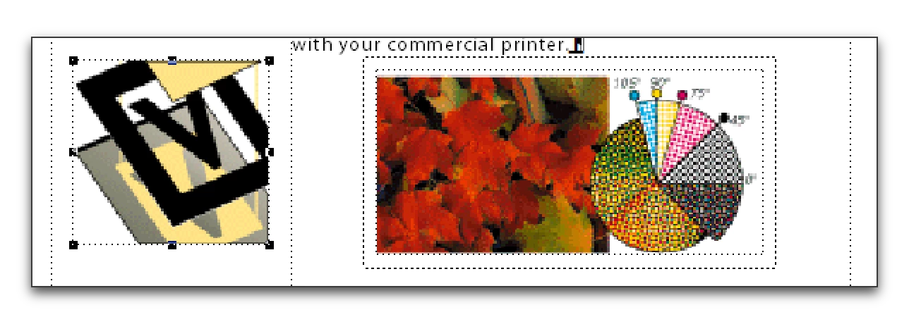

    The only concern I have about Fit into Selected Rectangle is you will need to watch the aspect ratio. If you replace the image on the right with the one on the left using Fit in Selected Rectangle...
    it changes the aspect ratio. Of course, I went for an extreme distortion to demonstrate the potential problem. I'd suggest that you keep an eye on it. Hopefully it won't be that bad, but depending on the files, it could be.
