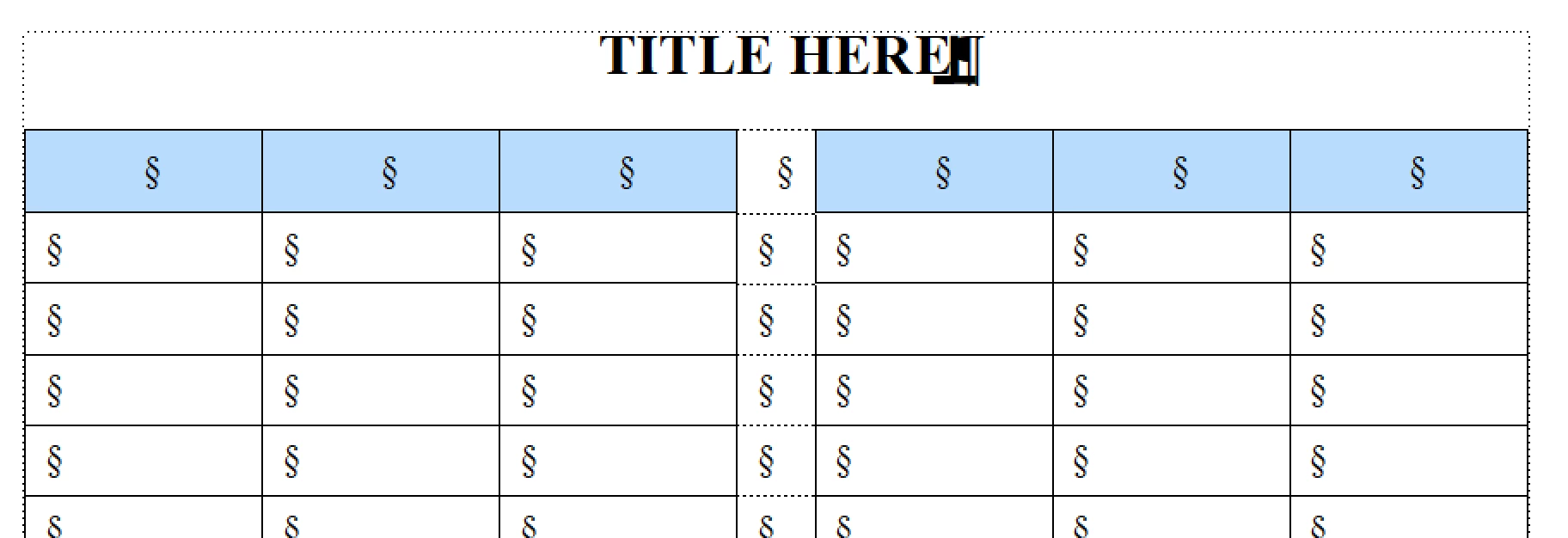

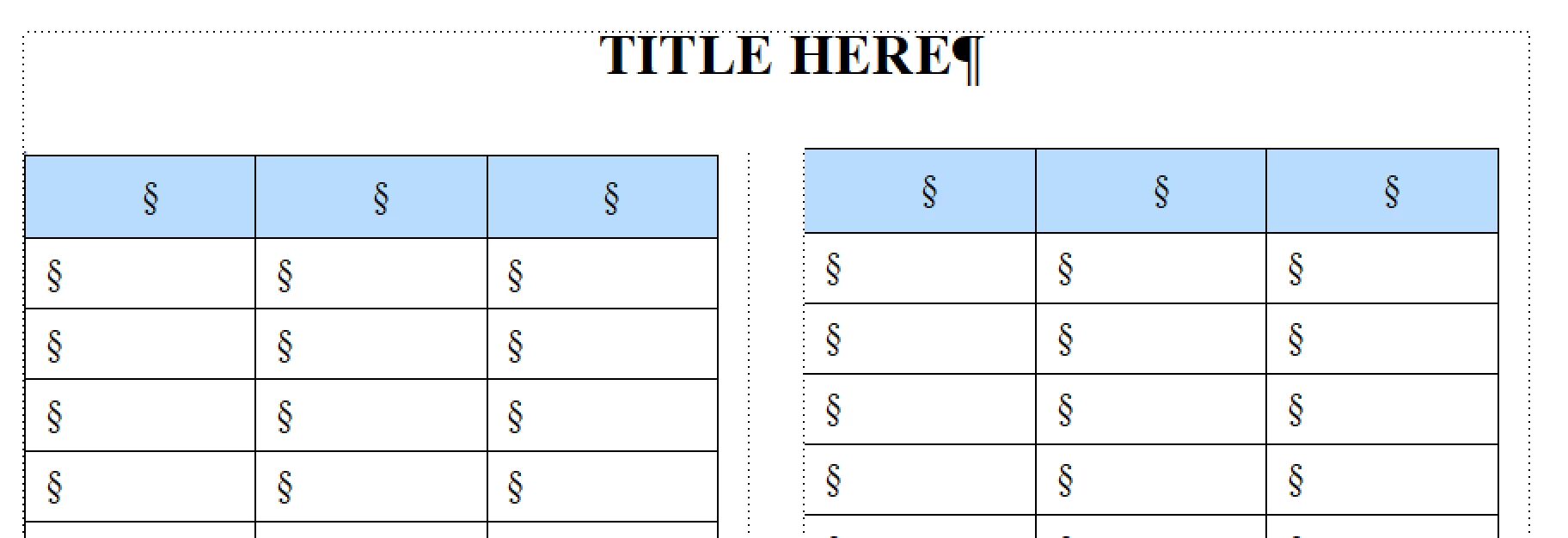

I am working on a new document type for my company. In this document, we have a two-column page set up, and are using a two-column table as well. However, we noticed that the table in column one is starting a milimeter or so below the table start in column two, which is creating a formatting offset. (See attached.)
Our table anchor is sitting on the line above the table, in column one, which is pushing this table lower on the page. When I attempt to move the anchor to sit against the document title, it pushes the table out of our two-column format and into a single column while also pushing the table onto the second page of the document, leaving the first page blank.
Does anyone have any suggestions on how to move the anchor to 1) remove the table offset and 2) preserve our two-column table?

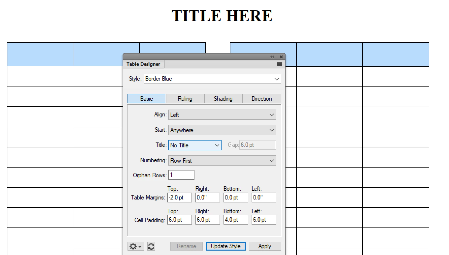

Try creating a table anchor tag (I call mine Anchor) that is set to a 2 pt font size. Then in the table designer for your table, set the top table margin to -2 pts.
[Side note: my practice is to have each table anchor in a separate paragraph. I find it's easier to select the one you want and also it lets you do tricks like the above, which keeps your table close to the preceding paragraph.]

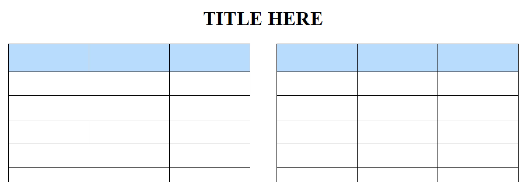

Ah, now I understand. From the two screen shots, I think Nicole has a two-column format with a straddle head and one long table underneath that needs to line up when it wraps back up to the top of the second column.

But Lin, what does this mean? I wasn't thinking about needing the two tables to be perfectly aligned across the two column frames. When I set the table top margin to -2 the two columns lined up perfectly. See my last screen shot. BTW, the table is anchored to an empty ¶, but the anchor isn't visible because it is 2 pts.
